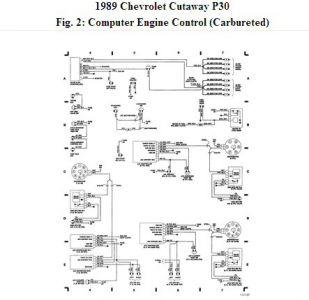

I don`t have electric going to my diverter valves. It has an elec. rely part #14101029 [ I am sure that is the problem] that they don`t make any more and the referee said he need proof that that was the problem. I need to find out what controls this because I cannot find any schematics that will show me this[where the wires go]. Where could I get this info? Thank You

you didn't say if yours if fuel injected or carb, but i think yours is carb. anyhow it should be very similar to what you have on your RV........ just blow it up so you can see it as it has 6 cylinder and 8 cylinder on it........
https://images.2carpros.com/forum/automotive_pictures/406719_motorhome_2_1.jpg
