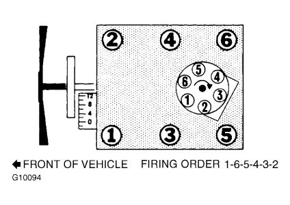

1989 CHEVROLET
I need to know the firing order for an 89 chevy 1500 4.3L?
Friday, December 12th, 2008 AT 10:01 PM
DAVE H
MECHANIC
13,384 POSTS
+14
Saturday, December 13th, 2008 AT 8:18 AM
