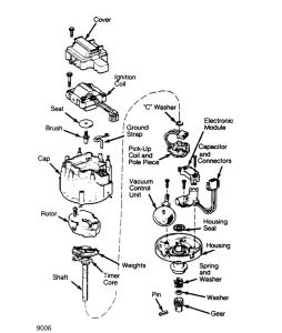

hello, i have a sbc 305 with everything stock, a week ago i was driving 45 down the road and all of the sudden the truck starts losing power and it backfires hard 4 times and shoots a bunch of debris out the exhaust. so when i was stopped i cut the exhaust at the y-pipe and it still is doing it. if you let it sit for a few minutes, it will start up and run fine for about 20-30 seconds then start loading up and running erratically, then when you try to give it some gas it will try to die and backfire. it just keeps doing this, is this a carb issue or a timing issue, or something else, any help would be appreciated, thanks

Put a timing light on it and if the timing is wacked then the pick up magnet on the distributor shaft is probably cracked and has moved. Either replace the distributor or install new shaft
https://images.2carpros.com/forum/automotive_pictures/30961_dist_2.jpg
IF timing is good check fuel pressure.

ok so i took the fuel line off the carb and fuel pumping out, so fuels good, ill get the pickup in tomorrow and install that. today i retimed the truck, brought 1st cylinder to tdc and set the distributor to cylinder 1. when cranking it still will not start, ive gotten it to backfire a few times but it wont start. i checked the spark and it was getting spark on 1, but we will see after i install that pickup. i also have a quadrajet off an 84 350 i will try, cause i heard mention that the carb might be shot. also, when it was running (barely) i would stick the choke plate shut and it would kick and carry on dying, then i would let it off (full open) and it would run ok for 20 seconds, then start sputtering and dying again.

ok so, i have installed new timing gears and the chain, and set the distributor to fire at #6. i have also replaced the rotor, ignition module and magnetic pickup. now when i try to start it, it spits fuel out of the carb in one spot or backfires, it is acting like it is 180 degrees out, thoughts? it is still doing the same thing, any response will be appreciated.

Is it still running okay for 20 seconds or so before it stalls out? OR has that changed?
IF this is the same, Then we need to determine what is being lost. Spark, fuel, timing/compression.
IF this is not running for the 20 sceonds, a second problem was created.
