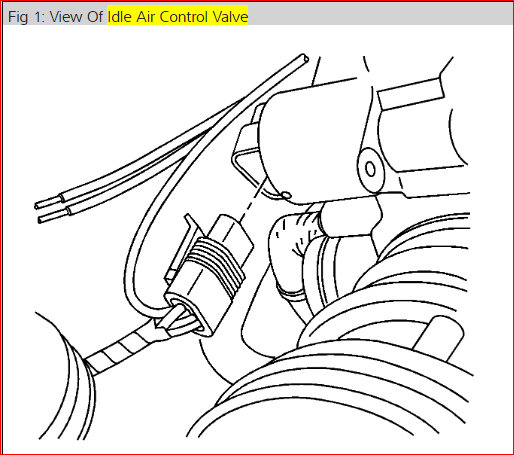

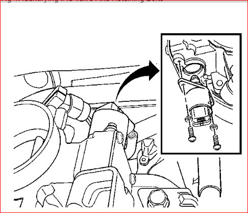

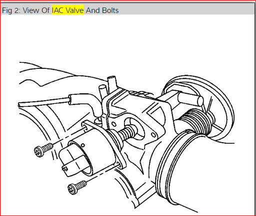

1.6 Chevrolet Optra 2004.
Sep 29, 2018 at 3:25 PM
DANNY L
  • 5,648 POSTS
Hello again.

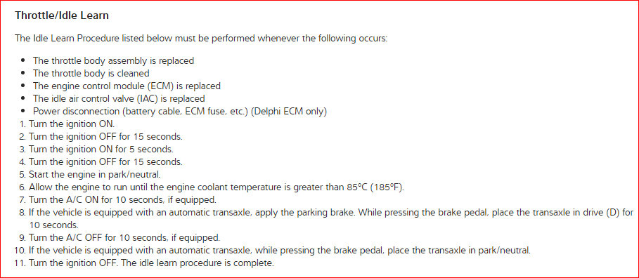

I have attached a picture of what the Idle Air Control Valve looks like. Do you see this located on your throttle body? I have also attached a relearn procedure. Hope this helps and thanks again for using 2CarPros.
Danny-
Sep 29, 2018 at 6:44 PM
JUDDYZAD23
Thanks for advice worked perfect!
