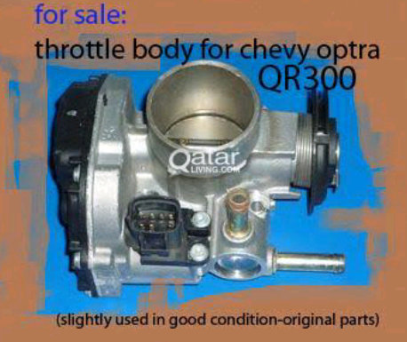

Hello again.
Is this what the throttle body on your car looks like? What size is the engine?
Danny-
Sep 29, 2018 at 10:10 PM
JUDDYZAD23
1.6 Chevrolet Optra 2004.

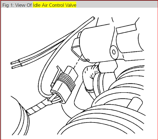

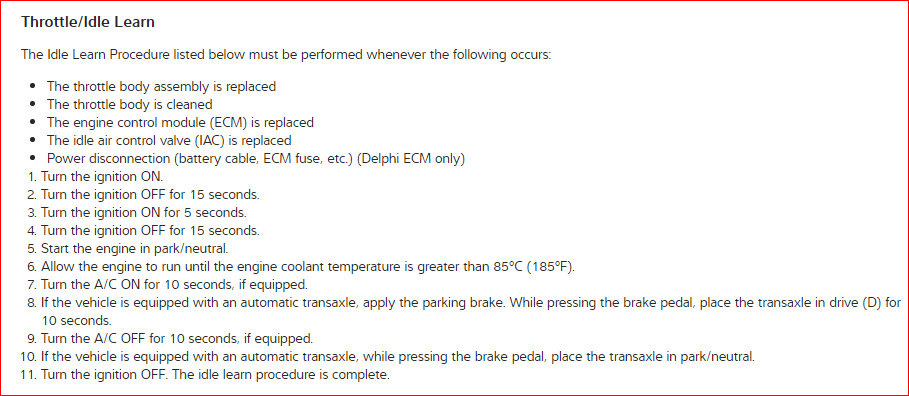

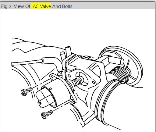

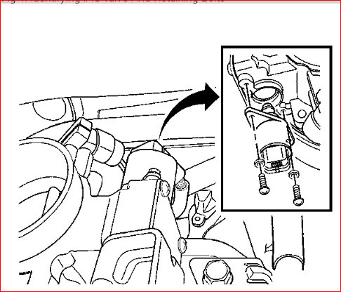

I have attached a picture of what the Idle Air Control Valve looks like. Do you see this located on your throttle body? I have also attached a relearn procedure. Hope this helps and thanks again for using 2CarPros.
Danny-
Sep 30, 2018 at 1:44 AM
JUDDYZAD23
Thanks for advice worked perfect!
