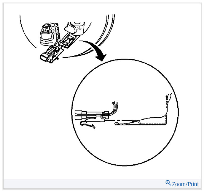

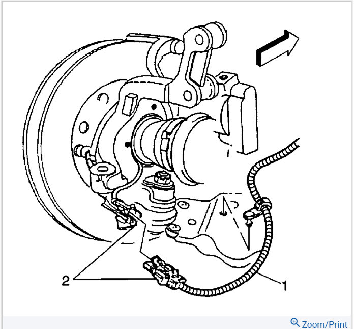

Check and see if the hub assembly is not bad. The speed sensor is built in to the assembly. The sensor goes bad, leading for the ABS/traction control to activate and always stay on in the info center in the car. Hope this helps. I had the a similar problem has to replace to hub due to the bad sensor.
Here is a video to help you to tell which sensor and hub is bad:
https://youtu.be/rTtAnsOlZU4
If you do not have a scanner try this.
https://www.2carpros.com/articles/abs-wheel-speed-sensor-test
Cheers

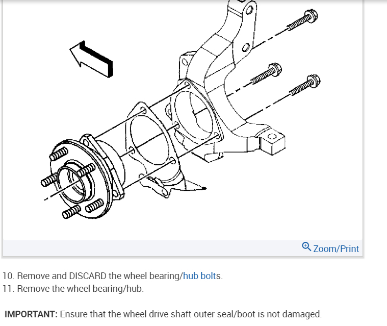

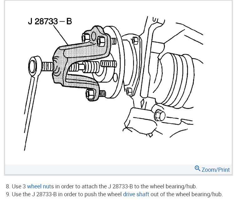

I had this problem as well had to replace the right front hub with sensor. Here is the guide I followed:
https://www.2carpros.com/articles/bearing-hub-replacement
Cheers
