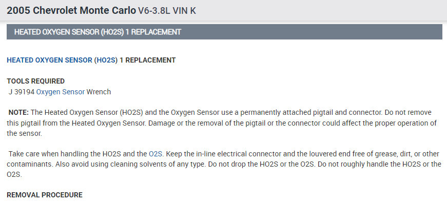

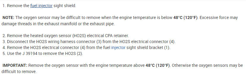

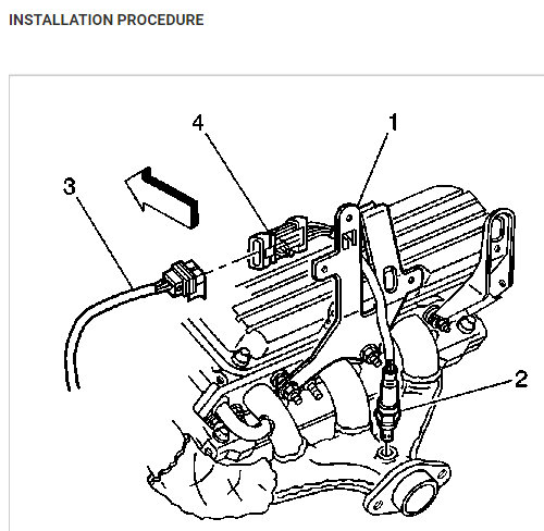

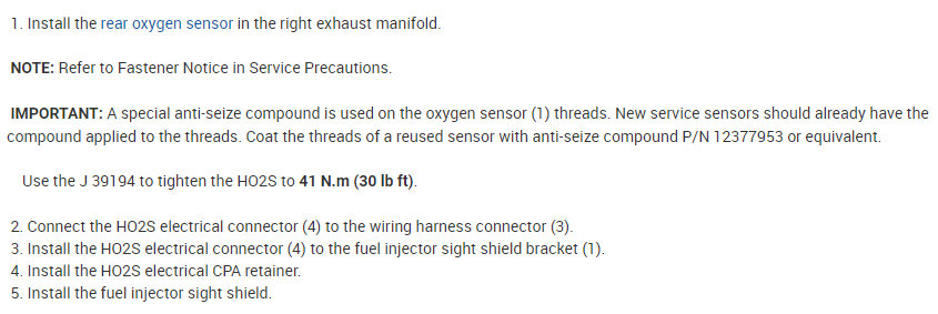

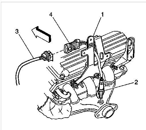

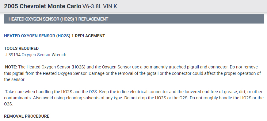

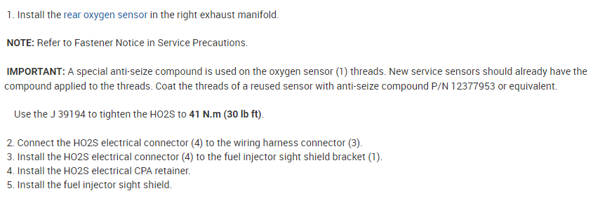

I need to change the bank 1 sensor 1 oxygen sensor
Thursday, March 25th, 2010 AT 7:51 PM
DANNY L
MECHANIC
5,648 POSTS
Hello, I'm Danny.
Here is the information you requested. This is a tutorial for you to view showing oxygen sensor replacement:
https://www.2carpros.com/articles/how-to-replace-an-oxygen-sensor
I've attached picture steps below showing oxygen sensor replacement and location for your car. Hope this helps and thanks for using 2CarPros.
