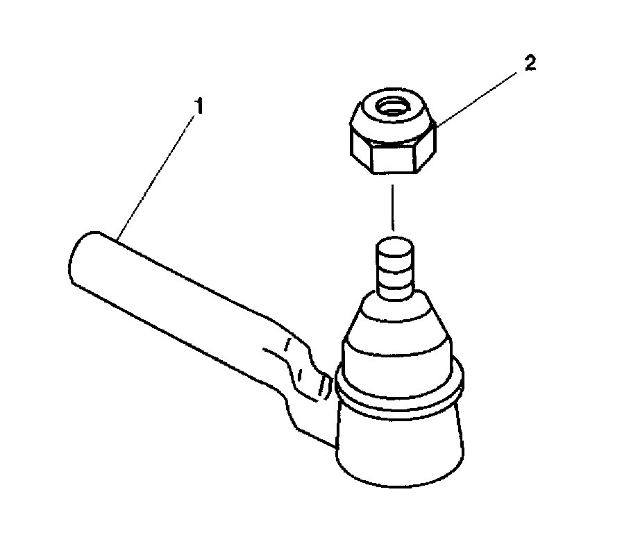

A worn tie rod won't always cause a shaking. Most times, you will notice play in the steering or outside or inside tire wear. Also, if one breaks, you will lose control of the steering, so it needs to be checked.
If you lift one front wheel at a time, place your hands at 3 and 6 o'clock and wiggle. If they are bad, you will feel play.
As far as replacement, here are the directions. Note: The vehicle will need to be aligned after this is done. To get it close, count the numbers of rotations the old tie rod takes to remove and then screw the new one on the same number. Or, measure from a fixed location.
The attached pics correlate with the directions.

Rack and Pinion Outer Tie Rod End Replacement
^ Tools Required
- J 24319-B Universal Steering Linkage Puller
Removal Procedure

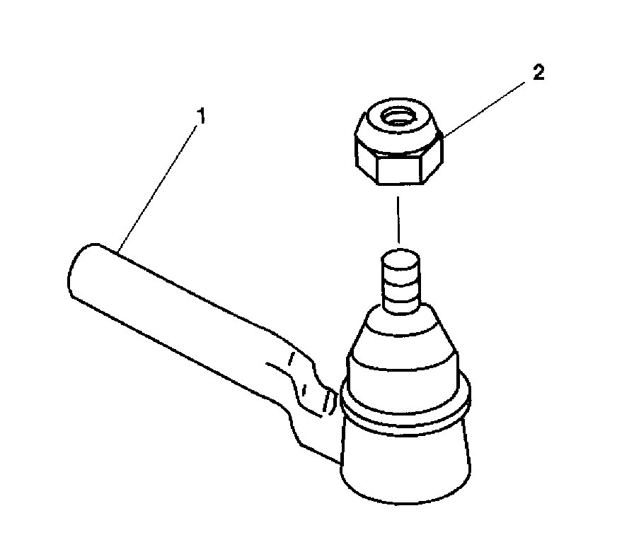

pic 1
1. Raise and support the vehicle. Refer to Vehicle Lifting.
2. Remove the tire and wheel assembly.
3. Remove the prevailing torque nut (2) from the outer tie rod assembly (1).

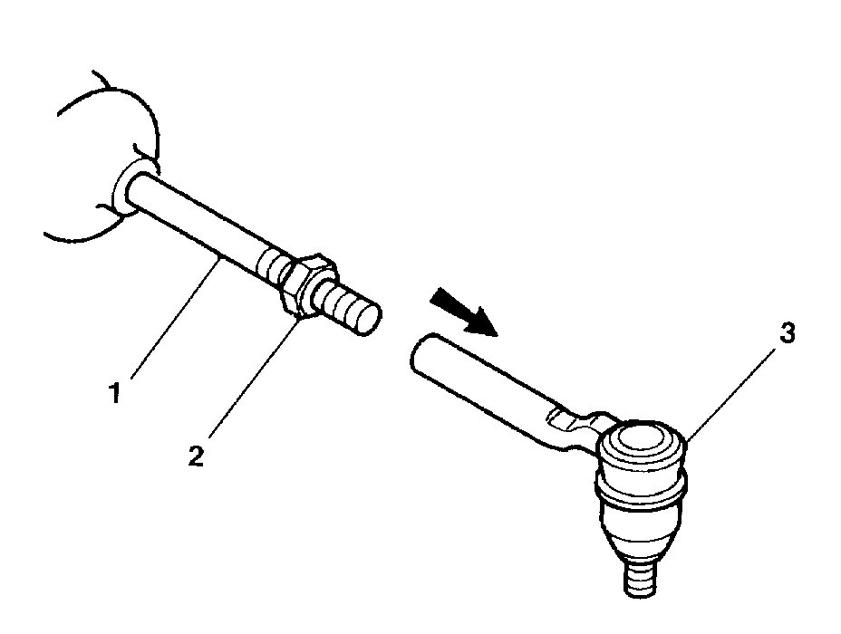

pic 2
4. Loosen the jam nut (2) on the inner tie rod assembly (1).

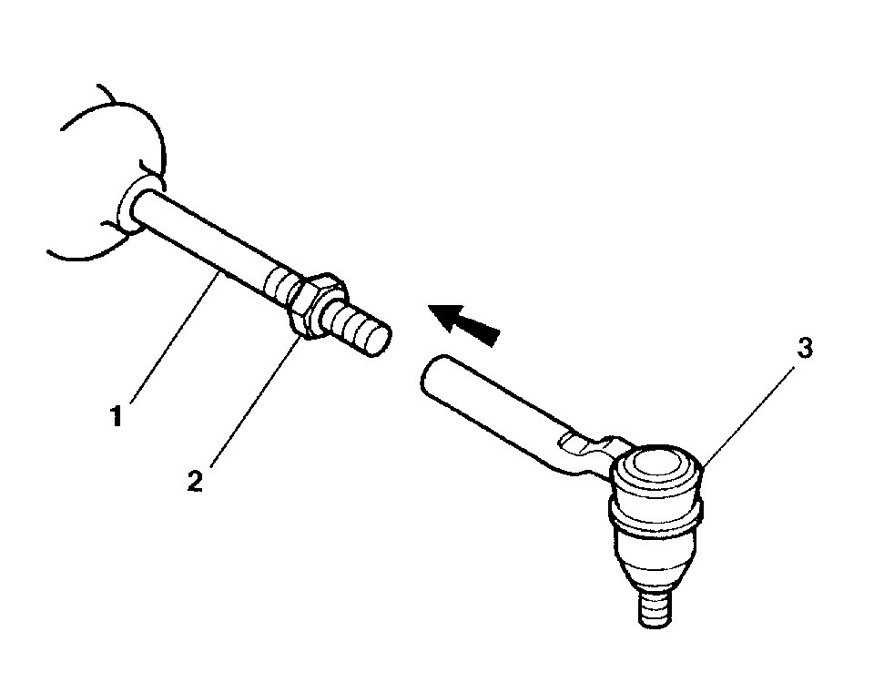

pic 3

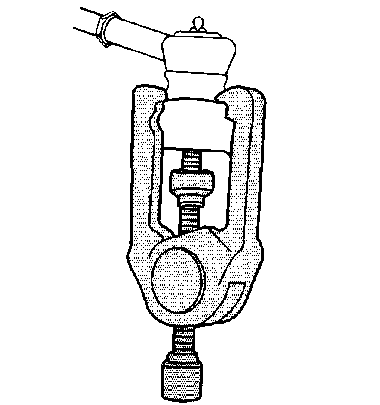

Notice: Do not attempt to disconnect a steering linkage joint by driving a wedge between the joint and the attached part. Seal damage may result which will cause premature failure of the joint.
5. Remove the outer tie rod assembly from the steering knuckle using J24319-B.

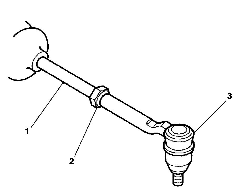

pic 4
6. Remove the outer tie rod assembly (3) from the inner tie rod assembly (1).

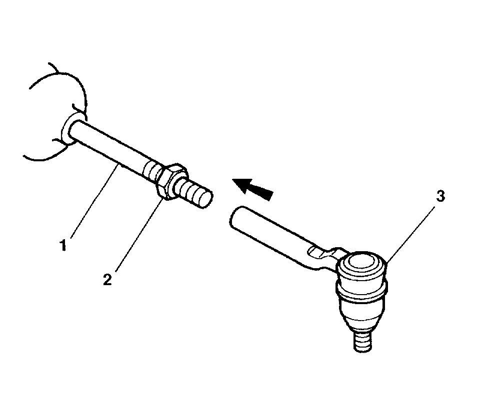

pic 5
1. Install the outer tie rod assembly (3) to the inner tie rod assembly (1). Do NOT tighten the jam nut (2).

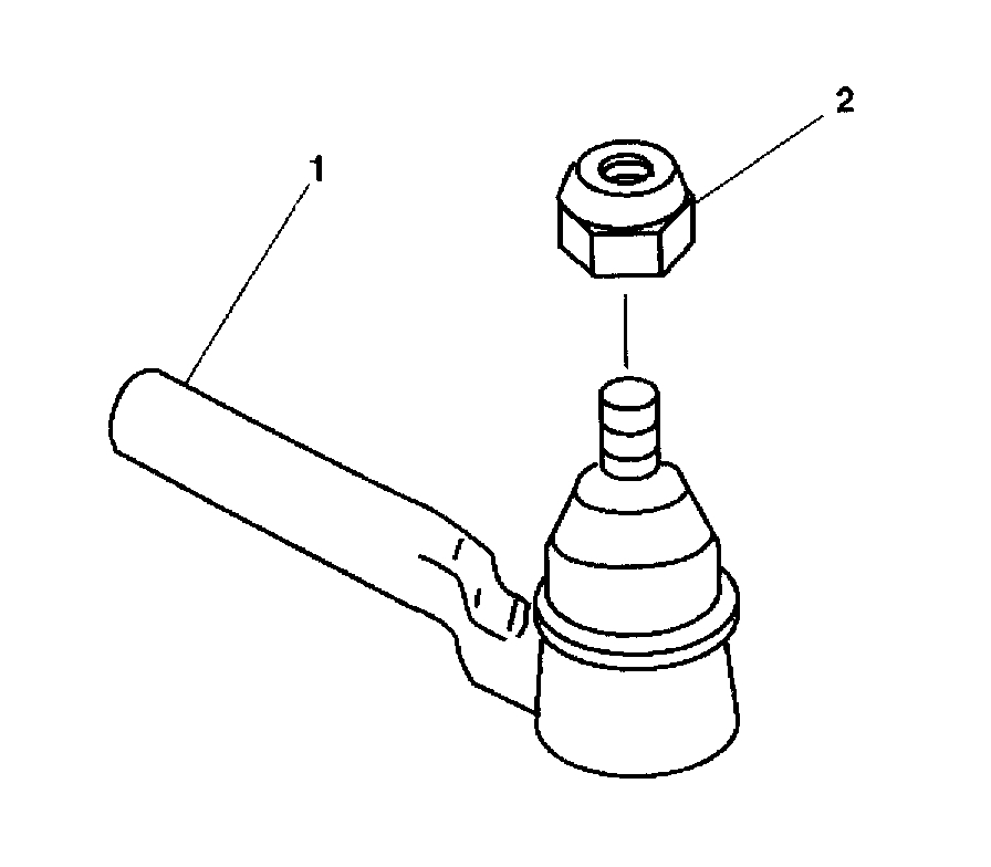

pic 6

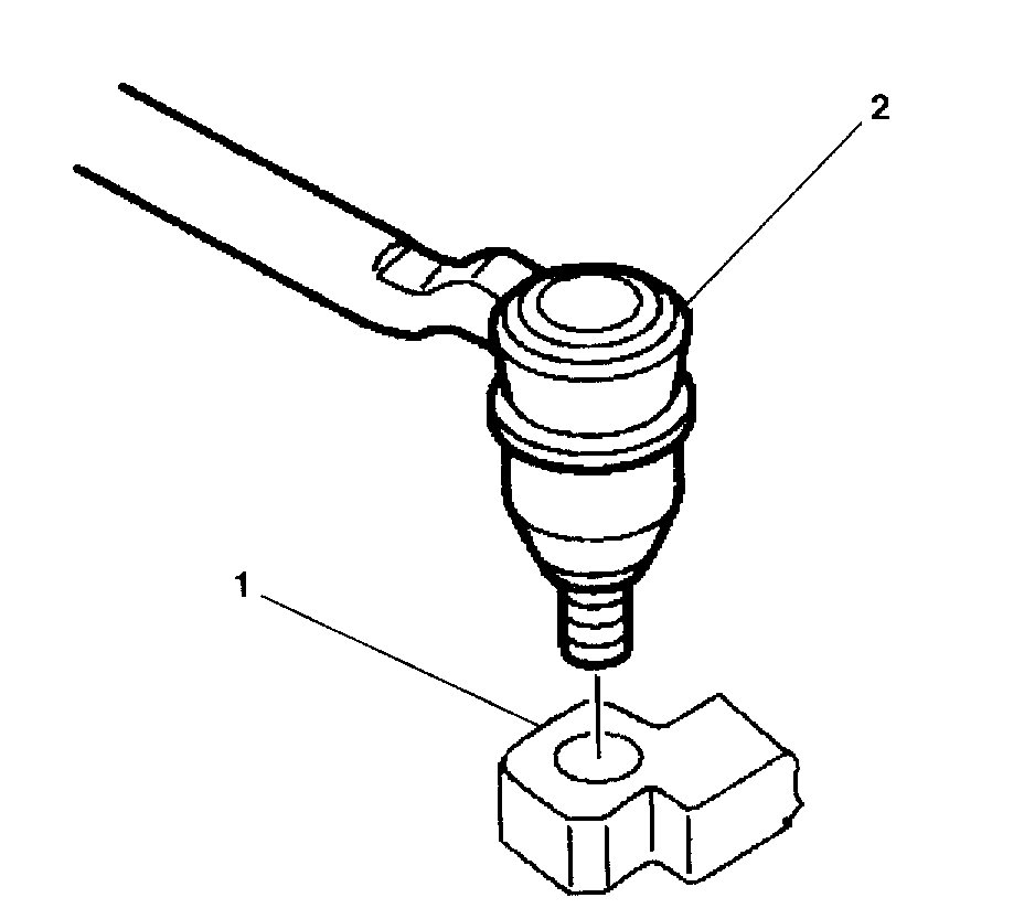

2. Install the outer tie rod assembly (2) to the steering knuckle (1).
pic 7
Notice: Refer to Fastener Notice in Service Precautions.
3. Install the prevailing torque nut (2) to the outer tie rod assembly (1).
^ Tighten the nut to 30 Nm (22 ft. lbs.) + 120° of rotation.
NOTE: Visually inspect to ensure that 2 1/2 - 4 1/2 threads are visible past the nylon washer.
Tighten the jam nut to 70 Nm (52 ft. lbs.).
