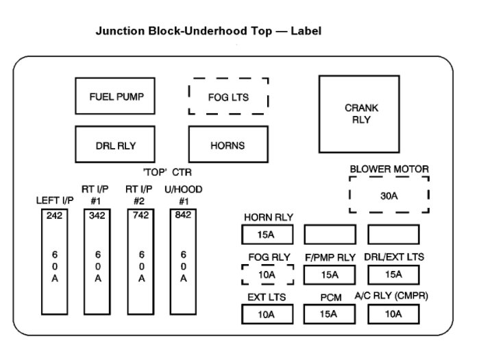

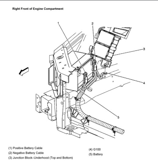

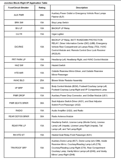

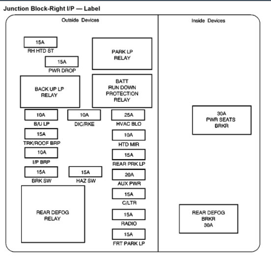

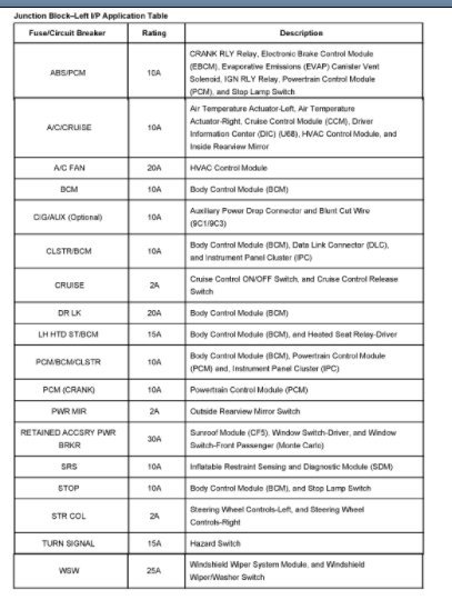

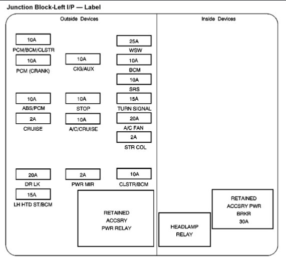

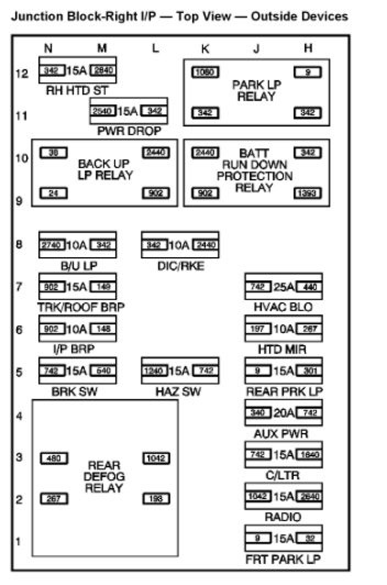

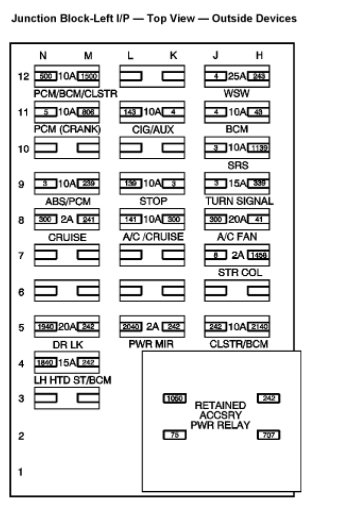

my car went into the ditch last winter, front end first, and now when it gets cold outside the speedometer wont work properly until the car has been running for about an hour. I want to check the fuses but dont know where there are or how to check them?
Nov 30, 2009 at 3:28 PM
DANNY L
  • 5,648 POSTS
Hello, I'm Danny.

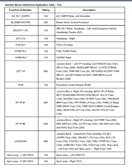

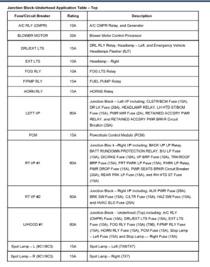

Here is the information you requested. Here are a few tutorials for you to view on how to check and replace fuses:
I've attached pictures below showing the fuse and relay locations on your car. Hope this helps and thanks for using 2CarPros.
