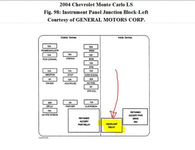

2004 Chevy Monte Carlo
cannot get the bright lights to go off. i dont even remember even turning them on. i do know that when i used them before when i pulled the handle back to turn them on u could feel it click. but now i dont hear or feel anything when i pull back the handle. i really would like to get them to go off before i get stoped by the police or cause someone to get into an accident. Thanks!
Aug 1, 2010 at 6:40 PM
MHPAUTOS
  • CAR REPAIR CONTRIBUTOR
  • 31,937 POSTS
Hi there, Check that this relay is not faulty, otherwise i would be having the switch tested start here. Mark (mhpautos)
https://images.2carpros.com/forum/automotive_pictures/61395_Capture_67.jpg
