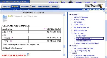

Check the fuel pressure and get back with the readings asap
https://www.2carpros.com/forum/automotive_pictures/12900_fp1_17.jpg
