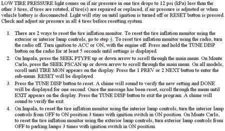

How do you reset the service vehicle soon light and the low tire pressure light?
Tuesday, March 11th, 2008 AT 2:48 PM
SERVICE WRITER
MECHANIC
9,123 POSTS
Need to pull codes from the pcm for the engine light.
This is the reset for the tire monitor:
