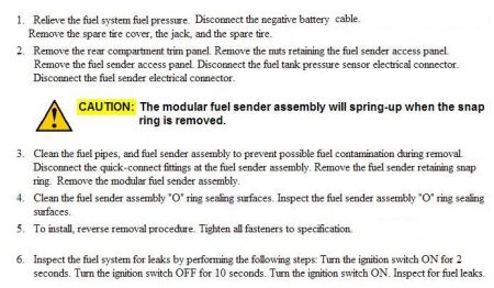

how to change the fuel pump

https://images.2carpros.com/forum/automotive_pictures/261618_Noname_1035.jpg
