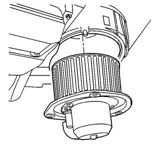

2000 Chevy Monte Carlo 6 cyl Two Wheel Drive 90,000 miles
Like to know how to replace the ac blower motor
Dec 15, 2007 at 10:52 AM
DENNYP
  • 1,824 POSTS

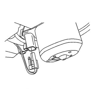

Blower Motor and Fan Replacement Removal Procedure Disconnect the battery negative cable. Refer to Battery Negative Cable Disconnect/Connect Procedure in Engine Electrical. Remove the right side instrument panel insulator. Refer to Insulator Replacement - Instrument Panel (I/P) in Instrument Panel, Gauges and Console. Disconnect the blower motor electrical connector. Disconnect the blower motor cooling hose. Remove the blower motor mounting bolts. Remove the blower motor.
