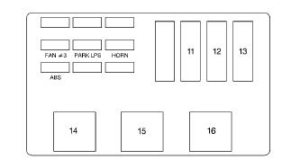

Tail lights and instrument lights no going on. Checked rear bulbs and found one burnt out, replaced.(Turn signal,reverse and brake lights now working.) Still no rear lights and instrument. Checked all interior fuses and seamed ok. Checked underhood on both passenger and drivers side. Can anyone tell me which fuse or breaker activates the rear and intrument lights

Welcome to the forum, thanks for the donation. Underhood, driverside fuse box, park/lamps fuse. Also, use a testlite on the fuse circuit, hot all the time.
https://images.2carpros.com/forum/automotive_pictures/170934_lamp_fuse_1.jpg
