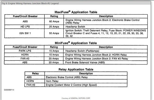

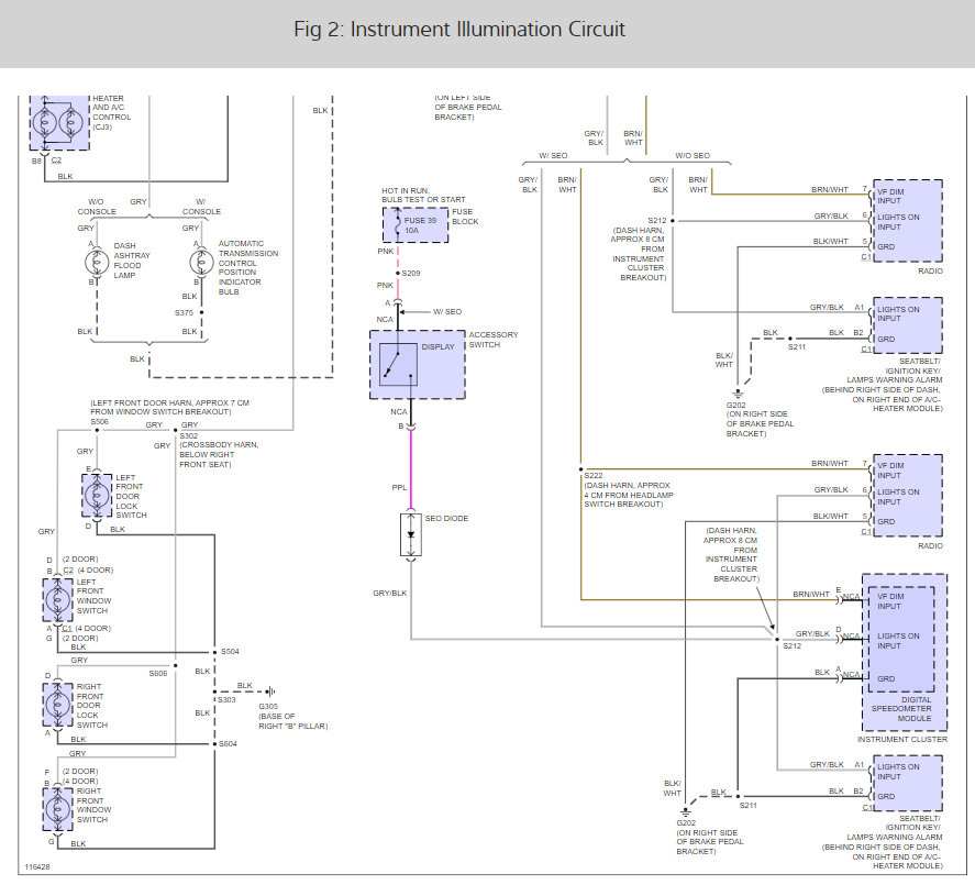

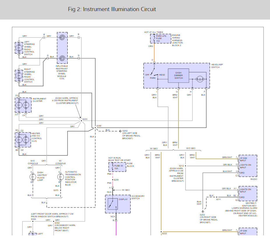

The Tail lights and dash lights are out I checked and replaced the bulbs. Is there a relay that controls turning ot dash lights out when the tail lights dont work. How do I find and replace it.
Jan 31, 2009 at 4:22 AM
KHLOW2008
  • 41,814 POSTS
Hi ww9d,

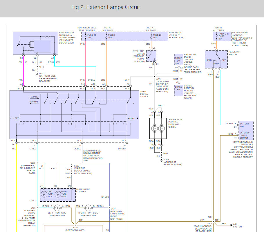

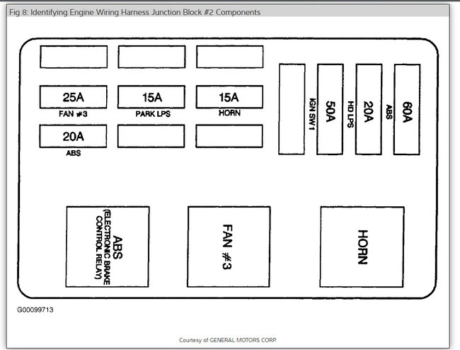

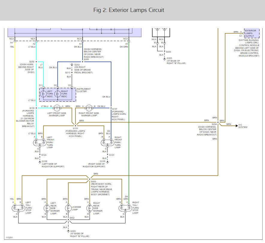

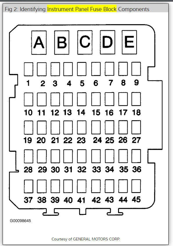

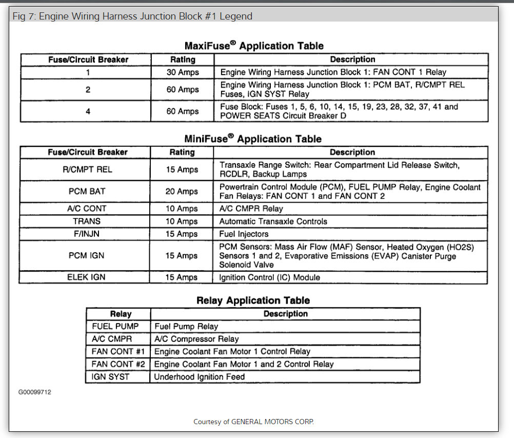

The taillights, dash lights and front side lights are all on the same circuit and is controlled by the light switch. Power supply is from Fuse # Park LPS ( 15 A ) located in junction block # 2 in engine compartment.
Here is a guide to help you check the fuse and the wiring diagrams for the systems so you can see how they work along with the fuse locations:
Cheers
Jan 31, 2009 at 5:42 AM
TWOOFUS
  • 0 POST
I had this problem and this post fixed it. Thanks guys! It was the fuse.
