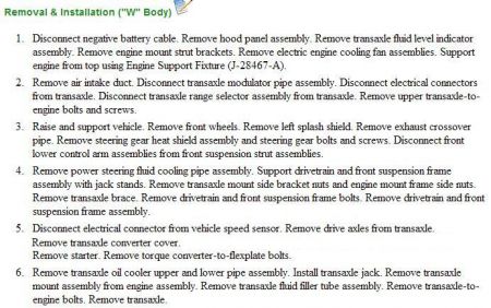

i am replacing the trans. and i have most of it complete but im stuck.i dont know the best way to drop the subframe to remove it.would i need to detach it at the lower ball joint and control arms?i would appreciate a solutuion.the motor is a 3.1 liter

https://images.2carpros.com/forum/automotive_pictures/261618_Noname_1695.jpg
https://images.2carpros.com/forum/automotive_pictures/261618_Noname2_537.jpg
