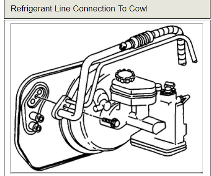

The A/C worked great last year & still blows cooler that just the vent but not as good as last year. Some one said it just needs recharged & it should be the new system I've read my owners manual & bought the r134a kit to recharge the a/c I have looked under the hood but don't see the compressor it may be underneath but I'm not sure. Any help will be appreciated. Thanks in advance.
http://www.2carpros.com/forum/automotive_pictures/176557_chc_veh_mon_ls_1998_1.jpg
I know how to recharge it I've done it to my truck before it's just the car is so jam packed under the hood I can't find any thing under there the battery is under the window washer tank. I'm having a hard time locating the accumulator

The low side charge port is on the larger of the two ac lines. Here is a video that will show you how to find it which it looks like it is near the brake master cylinder.

Thank you I love this site I am all set I will tell my friends :)
