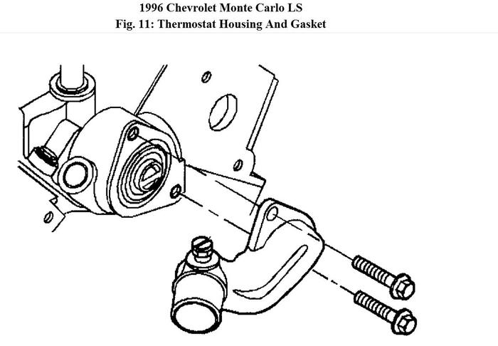

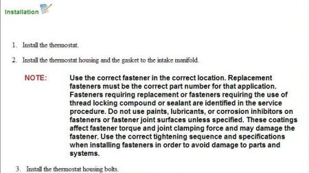

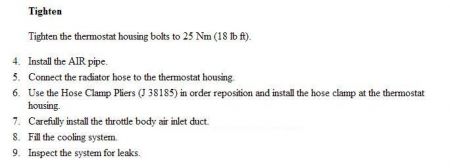

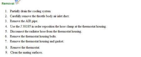

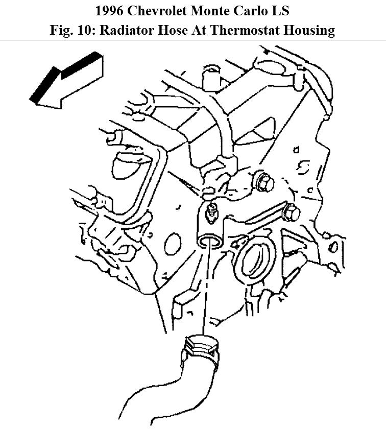

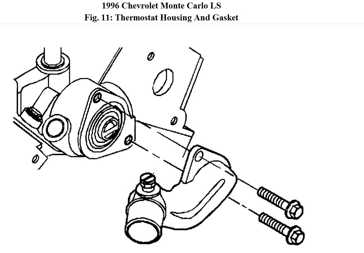

This guide will help you walk through the steps while the thermostat replacement for your car are in the diagrams below.
+6
Monday, August 12th, 2019 AT 7:13 PM (Merged)

BLUELIGHTNIN6
  • 16,542 POSTS
https://www.2carpros.com/forum/automotive_pictures/261618_Noname_1508.jpg
https://www.2carpros.com/forum/automotive_pictures/261618_Noname2_447.jpg
https://www.2carpros.com/forum/automotive_pictures/261618_Noname3_165.jpg
+3
