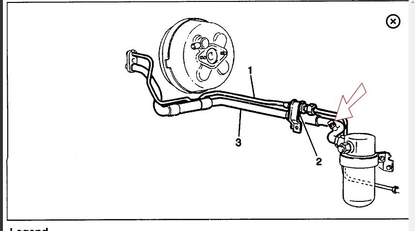

Hi, my '97 Monte Carlo LS recently stopped blowing cold air when the A/C is turned on. I have a can of Freon (or whatever you call it) with a gauge that i can put in to recharge the AC. My question is, where is the opening/plug for this? I need an image and/or a very detailed description of the location, because I can't find it ANYWHERE! I remember when my car had been fixed before, they took something off in order to get to it...
Any help would be GREATLY appreciated, because I need AC!

Yep its in a weird spot but I found it for you here is a diagram (BELOW) and a guide to ehlp you get the problem fixed.
https://www.2carpros.com/articles/air-conditioner-how-to-add-freon

where do i charge the ac in this vehicle 97 monte carlo
Jun 30, 2020 at 6:54 AM (Merged)
  • 75,988 POSTS
Look for the 13mm fitting which is the low side-no see video to find the port
https://youtu.be/ON2dYcmXIAw

I got a 1996 monte carlo z34 3.4 dohc engine and i want to no were do i put the freon at and whaf kind do i use.
Jul 13, 2020 at 6:49 AM (Merged)
  • 75,988 POSTS
Charge it at the low side pressure service port and use R134a.
LIONELL8732
  • 150 POSTS
Ok thanks alot and were is the low pressure port located at on my car.
  • 75,988 POSTS
Sorry, I've tried my auto references Mit1 and Alldata no location but the low side is always between the compressor and evaporator which is the suction line.
