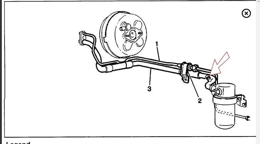

Hi, my '97 Monte Carlo LS recently stopped blowing cold air when the A/C is turned on. I have a can of Freon (or whatever you call it) with a gauge that i can put in to recharge the AC. My question is, where is the opening/plug for this? I need an image and/or a very detailed description of the location, because I can't find it ANYWHERE! I remember when my car had been fixed before, they took something off in order to get to it...
Any help would be GREATLY appreciated, because I need AC!

Yep its in a weird spot but I found it for you here is a diagram (BELOW) and a guide to ehlp you get the problem fixed.
https://www.2carpros.com/articles/air-conditioner-how-to-add-freon

where do i charge the ac in this vehicle 97 monte carlo

Look for the 13mm fitting which is the low side-no see video to find the port
https://youtu.be/ON2dYcmXIAw

I got a 1996 monte carlo z34 3.4 dohc engine and i want to no were do i put the freon at and whaf kind do i use.

Charge it at the low side pressure service port and use R134a.

Ok thanks alot and were is the low pressure port located at on my car.

Sorry, I've tried my auto references Mit1 and Alldata no location but the low side is always between the compressor and evaporator which is the suction line.
