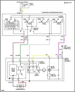

The wipers on this car do not work.. Could you tell me where the wiper motor is and what color wire to it is power?

should start with checking fuse to the wipers , fuse #29 (25 amp) in instrument panel fuse block. the wiper motor is on the left side of the firewall, in the engine compartment.
https://images.2carpros.com/forum/automotive_pictures/261618_Noname_2158.jpg
check the pink, dark green, grey an purple wires to see if they get power when switch is turned to each wire's position
