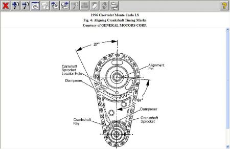

what do you do to line up the marks when they arn't their anymore,and how do i determine when they are correct with out pulling the heads to line up the upper cams

Put the no.1 piston on its compression stroke/TDC then align the cam and crank sprockets-see below
https://images.2carpros.com/forum/automotive_pictures/12900_timing_marks_3.jpg
