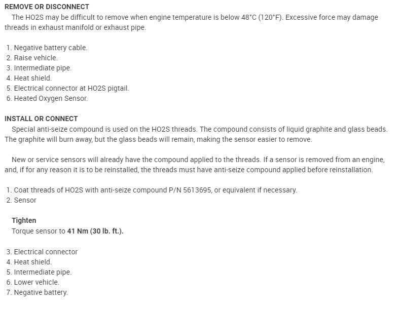

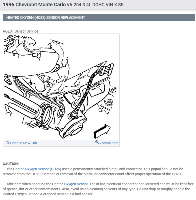

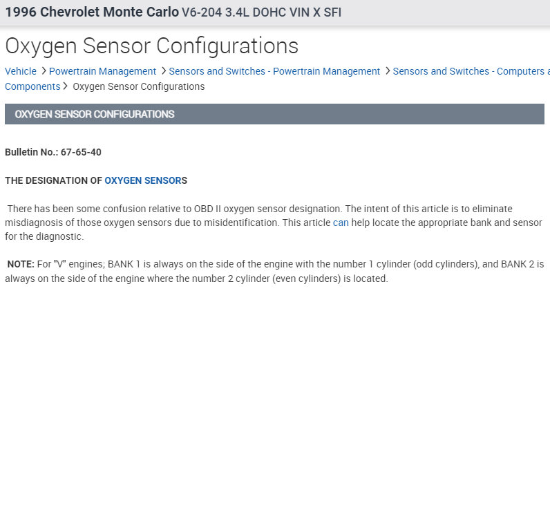

I just want to no where is bank 1 02 sensor is located at on my 1996 monte carlo z34 3.4 Dohc engine.
Aug 16, 2010 at 11:23 PM
SQM
  • 6,383 POSTS
The bank 1 sensor 1, oxygen sensor is located on the exhaust manifold that is close to the firewall.
https://www.2carpros.com/articles/how-to-replace-an-oxygen-sensor
