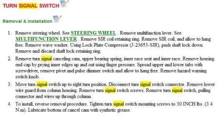

How do I change my signal light switch?
Sep 19, 2009 at 3:58 PM
F4I_GUY
  • 3,302 POSTS
https://images.2carpros.com/forum/automotive_pictures/276698_monte_carlo_switch_1.jpg
