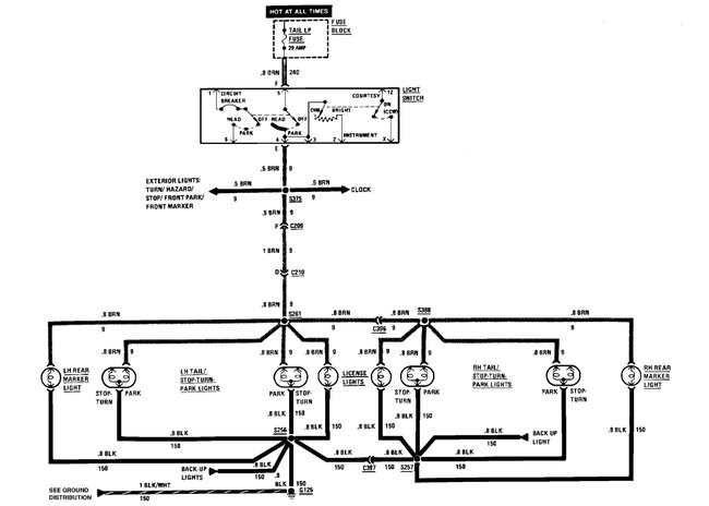

i replaced light bulbs , check fuses, and no lights only ones working is in the front?

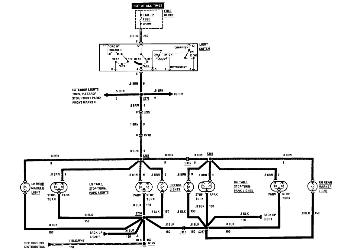

You must have a broken wire (brown) going to the rear of the car, here is a guide to help test for power and the tail light wiring diagrams so you can see how the system works and which wires to test.
Check out the images (Below). Please let us know how it goes
