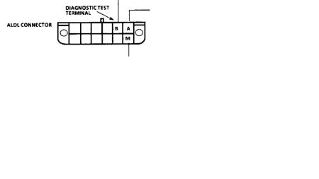

If you have a 12 pin data link connector, under the dash, you can check mil codes. You place a jumper wire between the A & B terminals of the datalink connector, turn key just till the dash lites come on, no further. The check engine lite starts flashing, you count the flashes to get the codes. Your lookin for two digit codes. The picture below is just to show location of terminals A & B.
