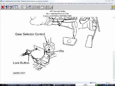

WHERE IS THE "SHIFT LOCK SOLENOID" LOCATED ON THE 97 CHEVY MALIBU LS? IS IT EAST TO CHANGE?
97 CHEVY MALIBU LS, 6 CYL, APPROX 95000 MILES

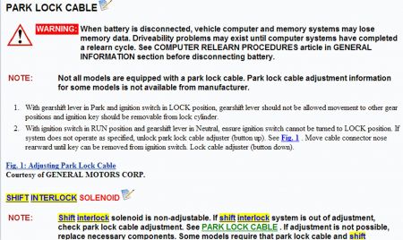

What makes you think it's bad? May just need to adjust park lock cable or stop light switch? Here's how...
https://images.2carpros.com/forum/automotive_pictures/62217_Cable_1.jpg
https://images.2carpros.com/forum/automotive_pictures/62217_Cable2_1.jpg
