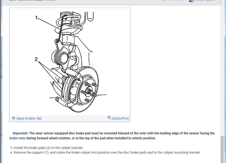

I had my front brakes replaced at 50k miles, I'm at 70k miles 5 months later and my front end is shaking and the brakes are squeaking again. How many miles should I get from a brake job?

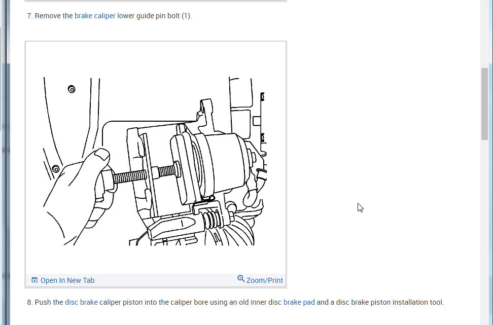

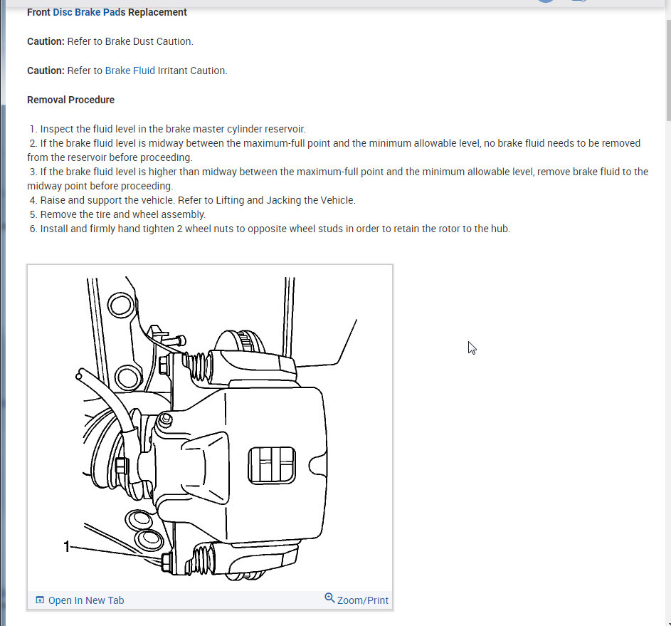

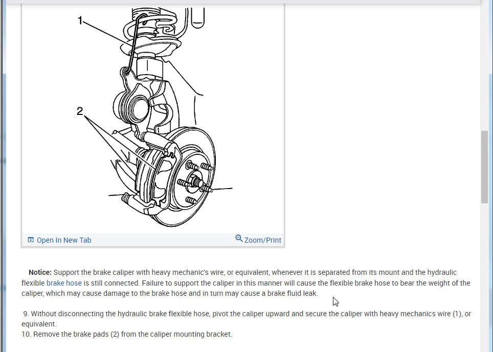

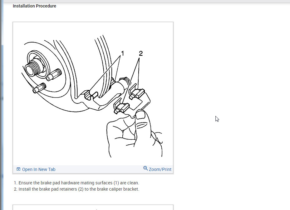

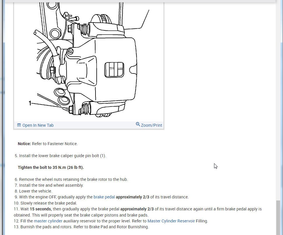

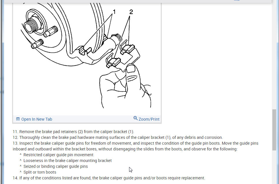

Here are a few guides that will help with this:
https://www.youtube.com/watch?v=CrTaafbfk0s
Plus the process from the manual is attached below. Please let us know if you have other questions.
Thanks
