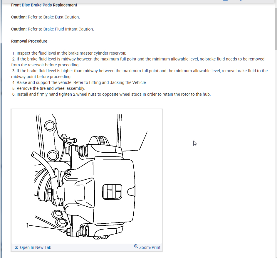

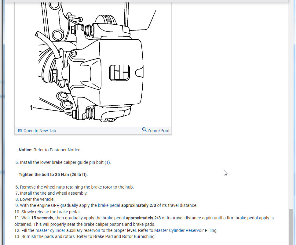

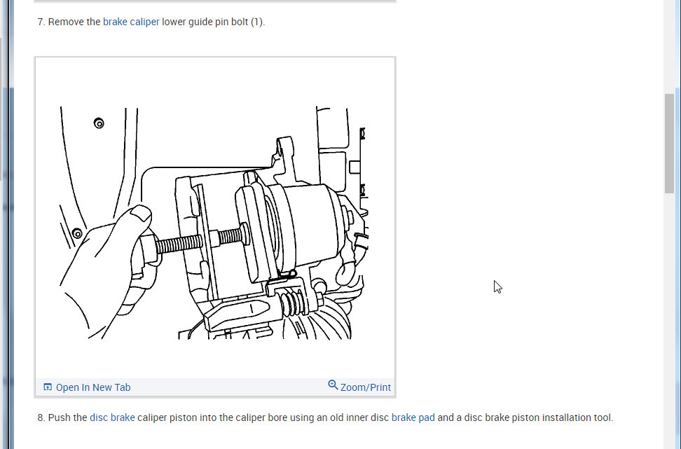

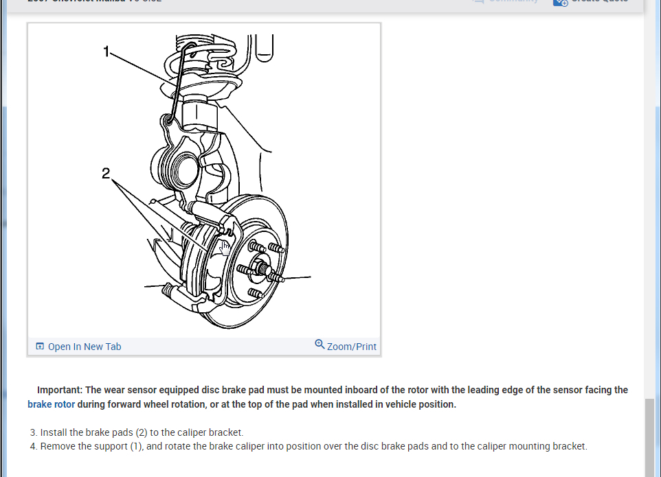

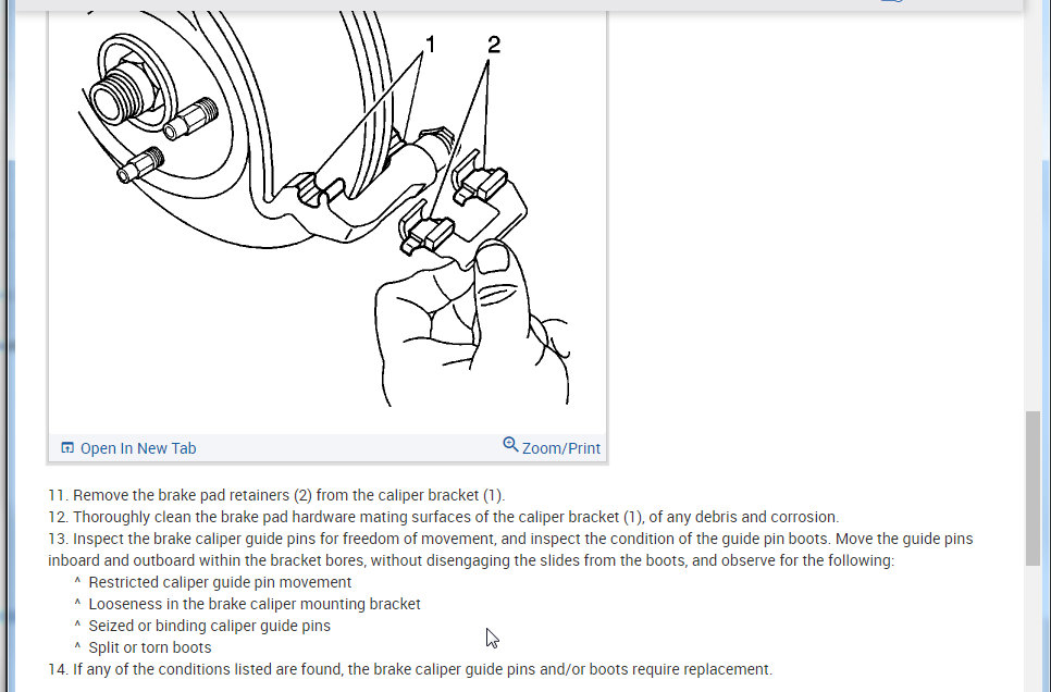

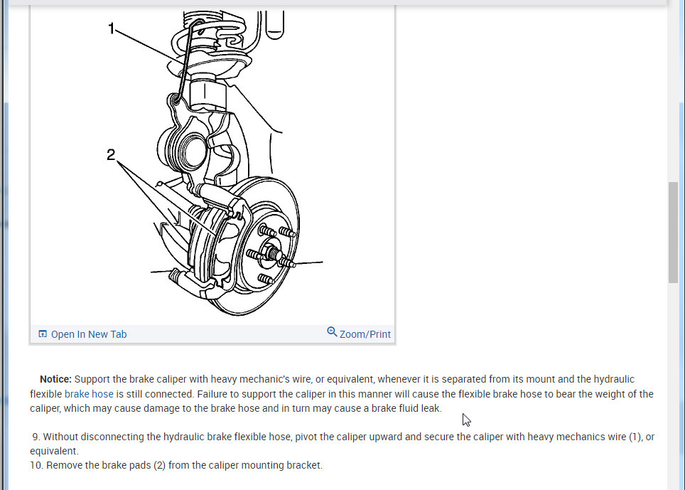

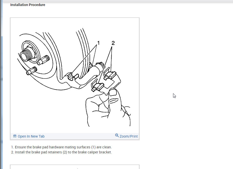

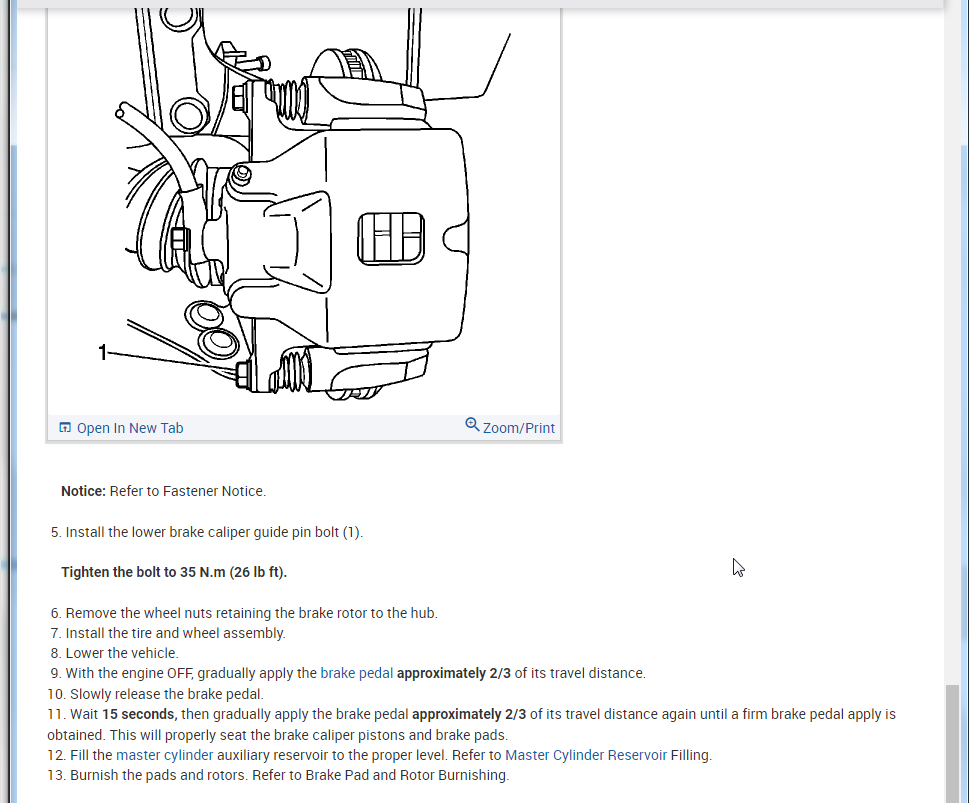

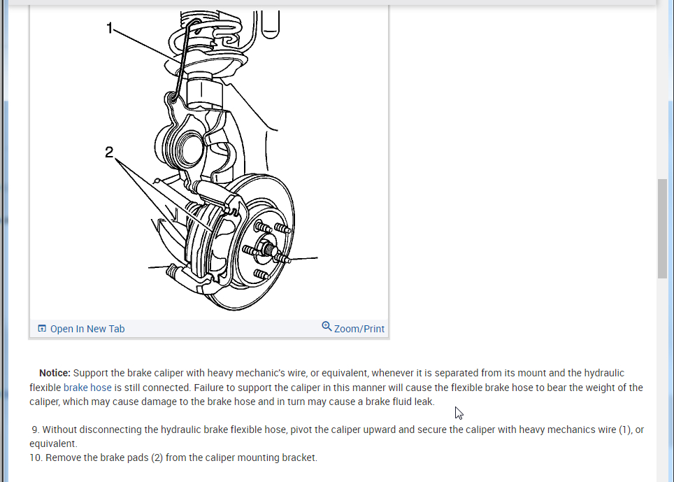

Plus the process from the manual is attached below. Please let us know if you have other questions.
