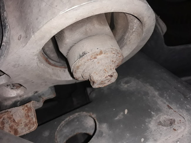

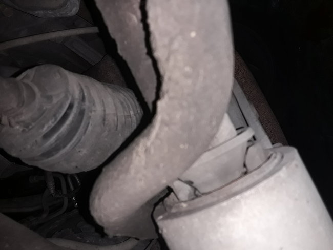

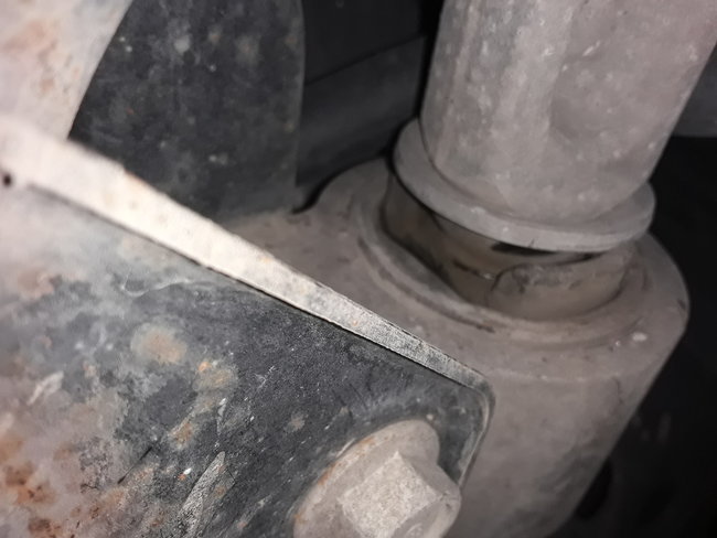

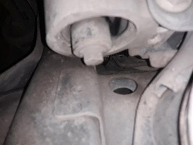

ADAMSJOHN
Everything seemed fairly tight when i wiggled around on everything, but found this on the arm that holds the wheel hub and everything. is it likely that this could be moving in and out? it is in the same direction that the wheel moves in.
Sep 11, 2020 at 1:41 PM (Merged)
  • 110,194 POSTS
Welcome to 2CarPros.

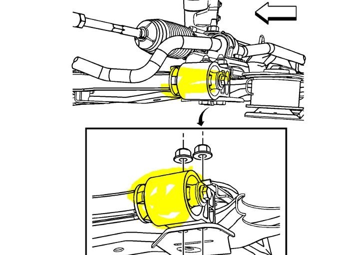

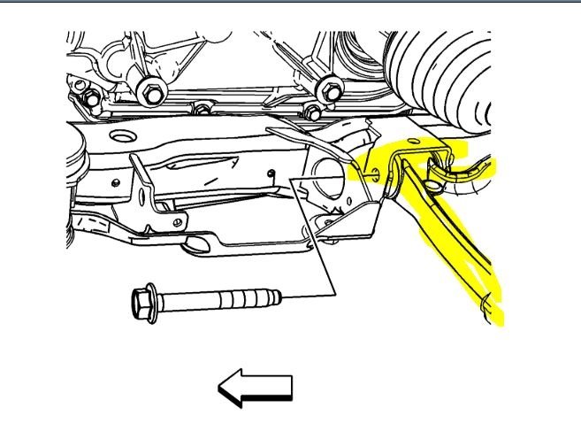

In the pictures you provided, am I looking at the control arm? That is what it appears to be. The control arm bushings may be worn. If they are bad enough, it can allow the wheel to move when you accelerate or brake.
Take a look at the pictures I and 2 attached. I highlighted the bushing which I believe is what you are showing us. Please confirm that.
Let us know.
ADAMSJOHN
yes it is. it looks like maybe its suppose to look like that.

ADAMSJOHN
today i am going to lay a camera under it facing up and get a video while i am tapping the brakes to make it move. to see if i can visually see the control arm move..
CARADIODOC
  • 34,321 POSTS
Control arm bushings used to last the life of the vehicle, but with demands for better ride quality, today they are made from softer rubber compounds, and failures are real common.
The biggest problem is you can't identify most worn parts by just poking at them unless they're really bad. The vehicle has to be jacked up and supported in very specific ways, then we use a combination of pry bars and helpers to make the looseness visible. Often we have to change how the vehicle is supported to check some parts because any loading has to be removed so the part is free to move around.
The other thing to be aware of is your very first sentence when you referred to shaking. A worn control arm bushing can allow shaking to occur, but it will never cause it. Any type of shaking, vibration, steering wheel oscillations, or brake pedal pulsation has to be caused by something that is rotating. That includes bent wheels, broken tire belts, warped brake rotors, wheel bearing hubs, (very uncommon), and the elusive inner CV joints.
