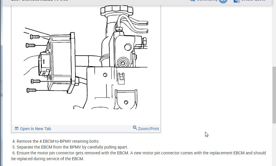

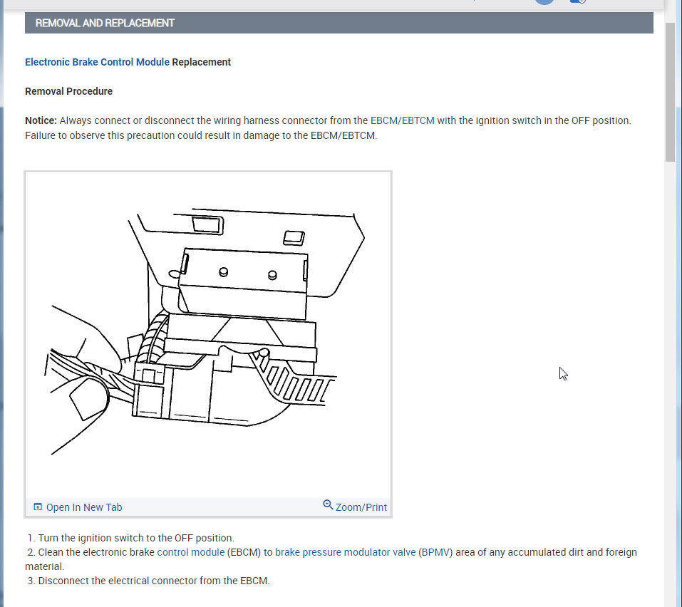

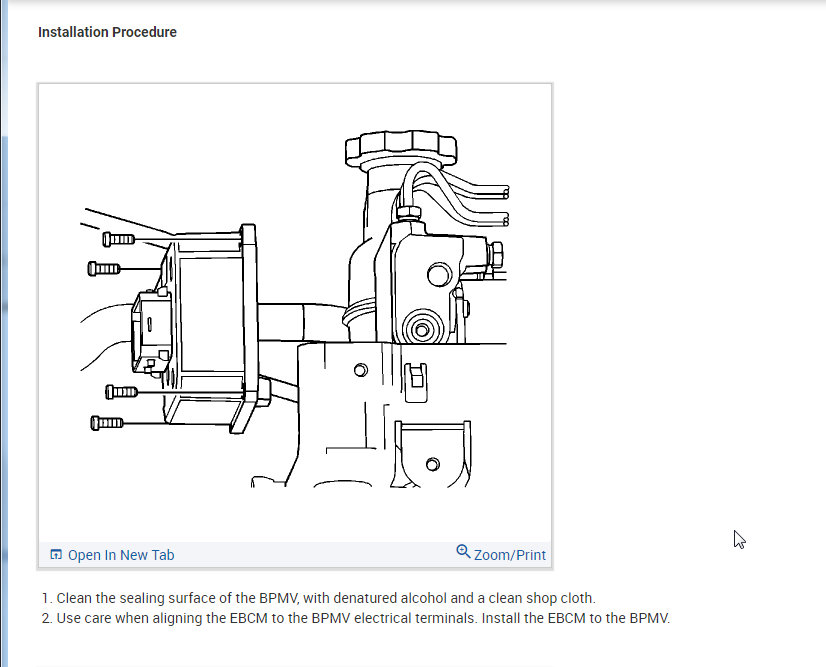

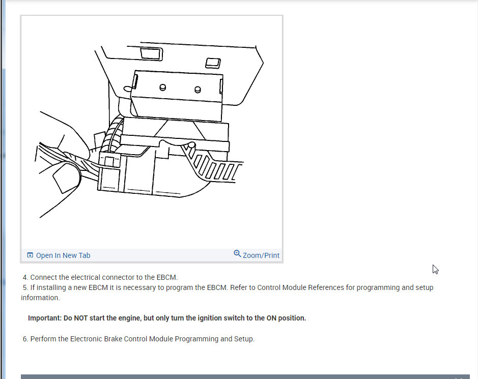

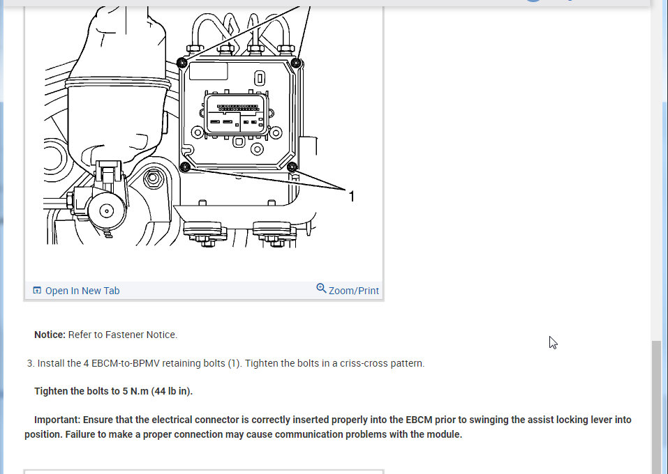

Below you will find the process from the manual that will help with this.
Run through this material and let us know if you have other questions. Thanks
