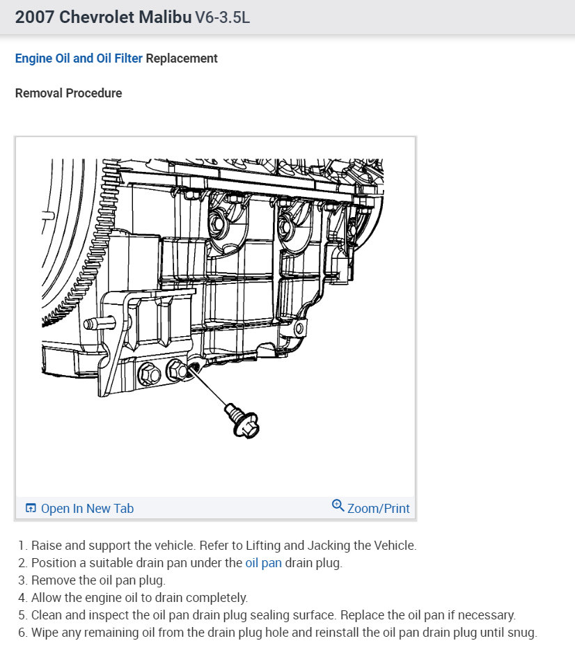

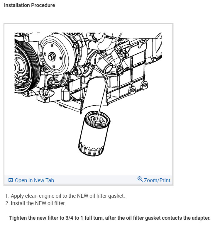

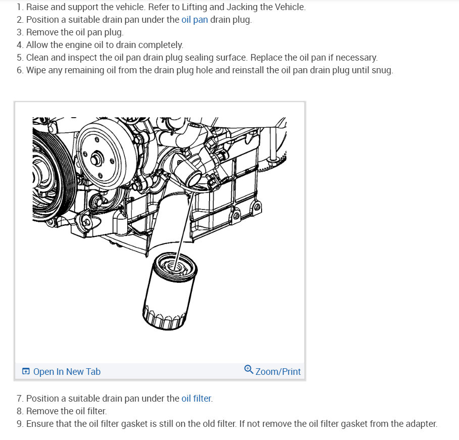

Where is the oil filter located?
Saturday, February 16th, 2008 AT 9:40 AM
9 Replies
DENNYP
  • 1,824 POSTS
The oil filter is at the front of the engine down low here is a guide to help walk you through the steps of changing it with instructions for you car in the diagrams below.
https://www.2carpros.com/articles/how-to-change-engine-oil-and-filter
