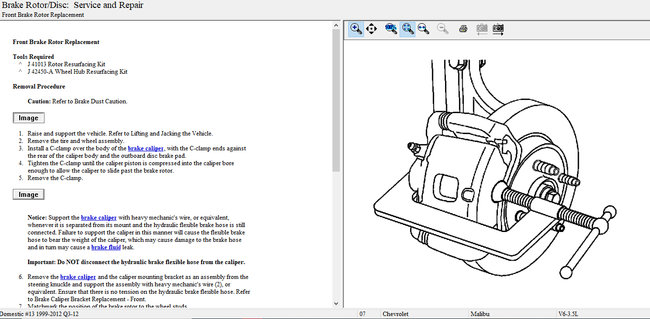

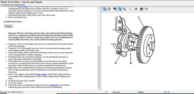

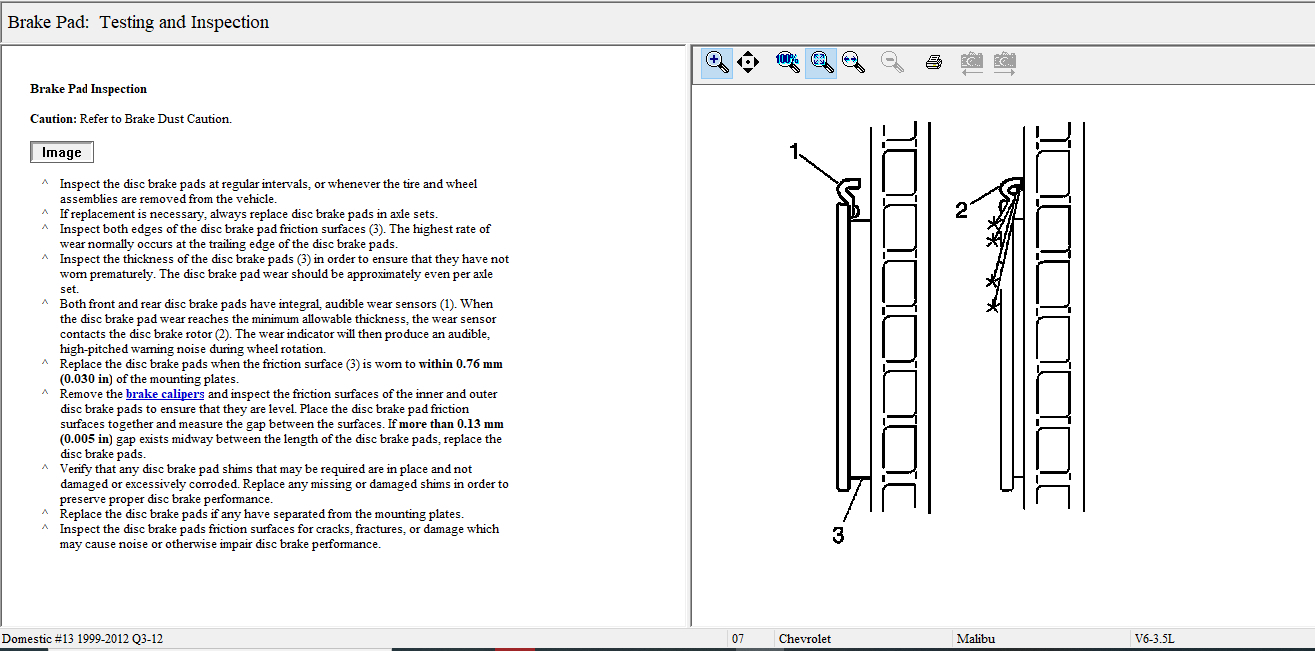

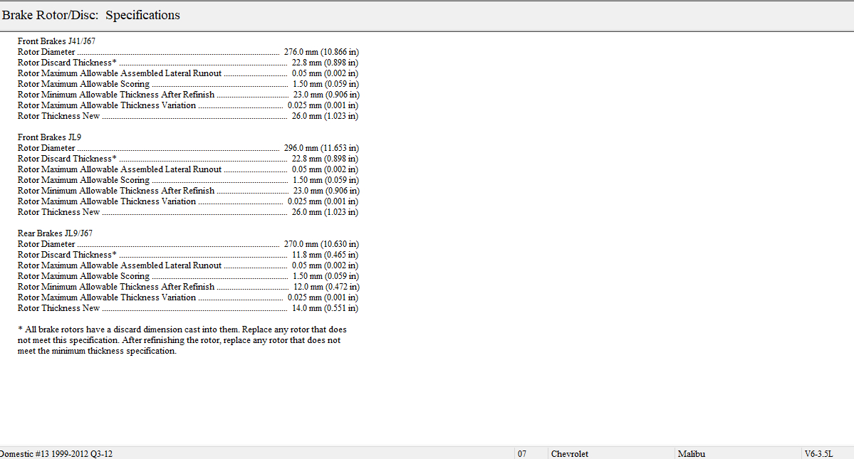

One thing is a popping noise in the left front. I have not owned a car in a while but I think it is the brakes. I think we are taking it in next week. But I kinda wanted to know before I get there and if I can do the job myself? Thanks Rlanier

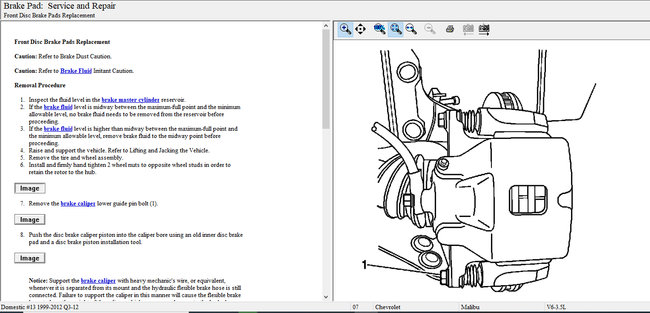

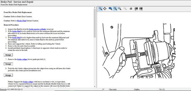

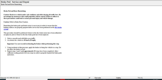

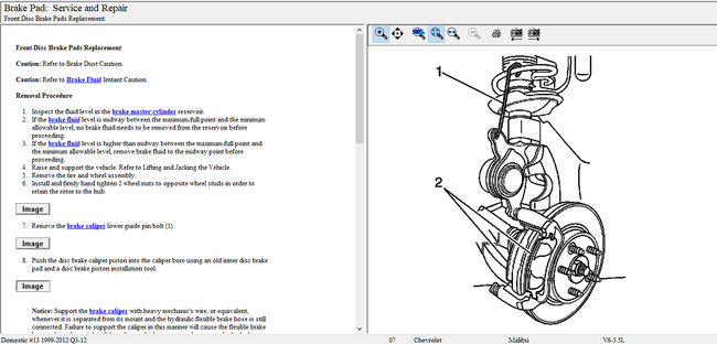

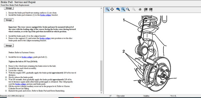

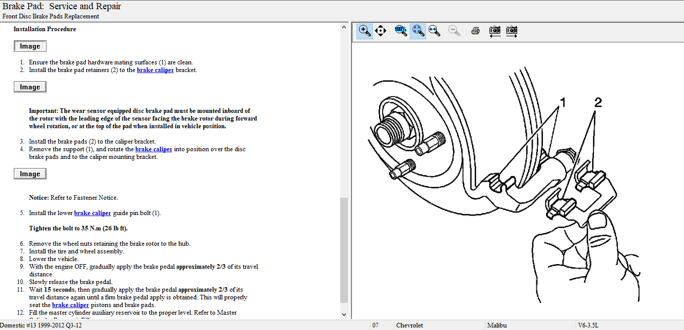

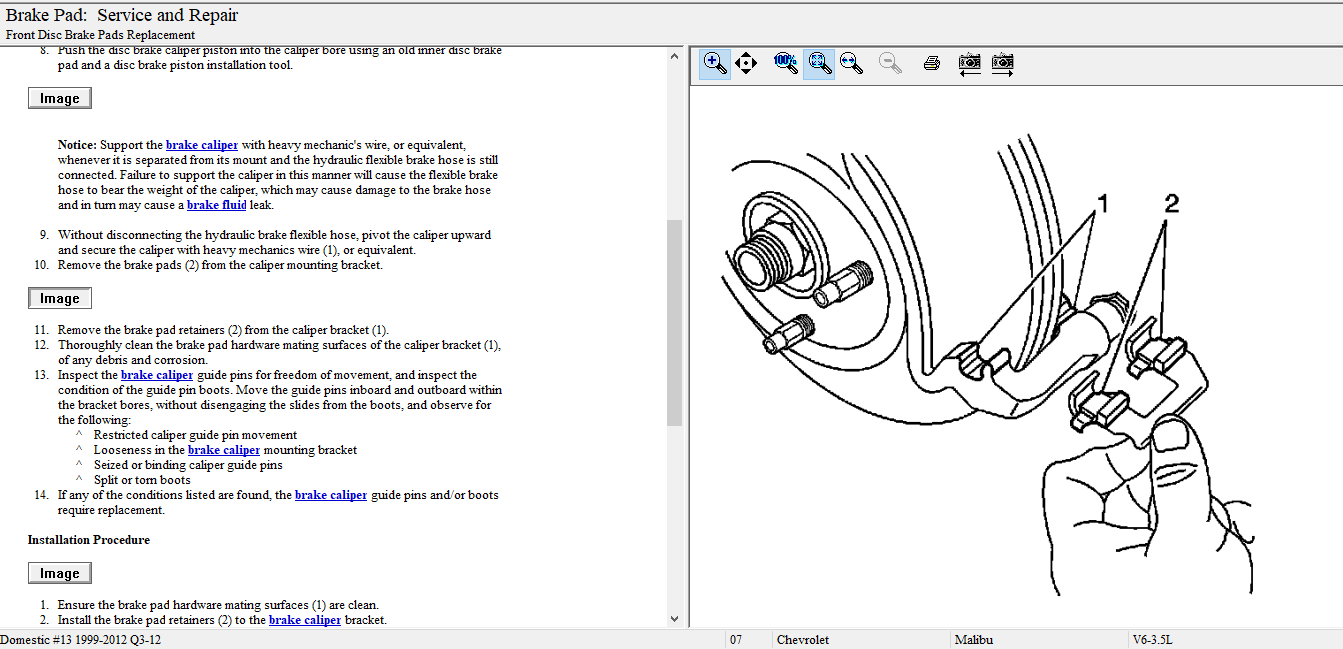

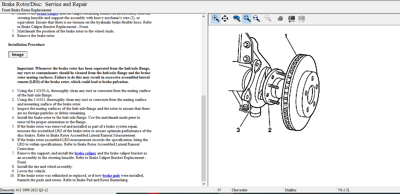

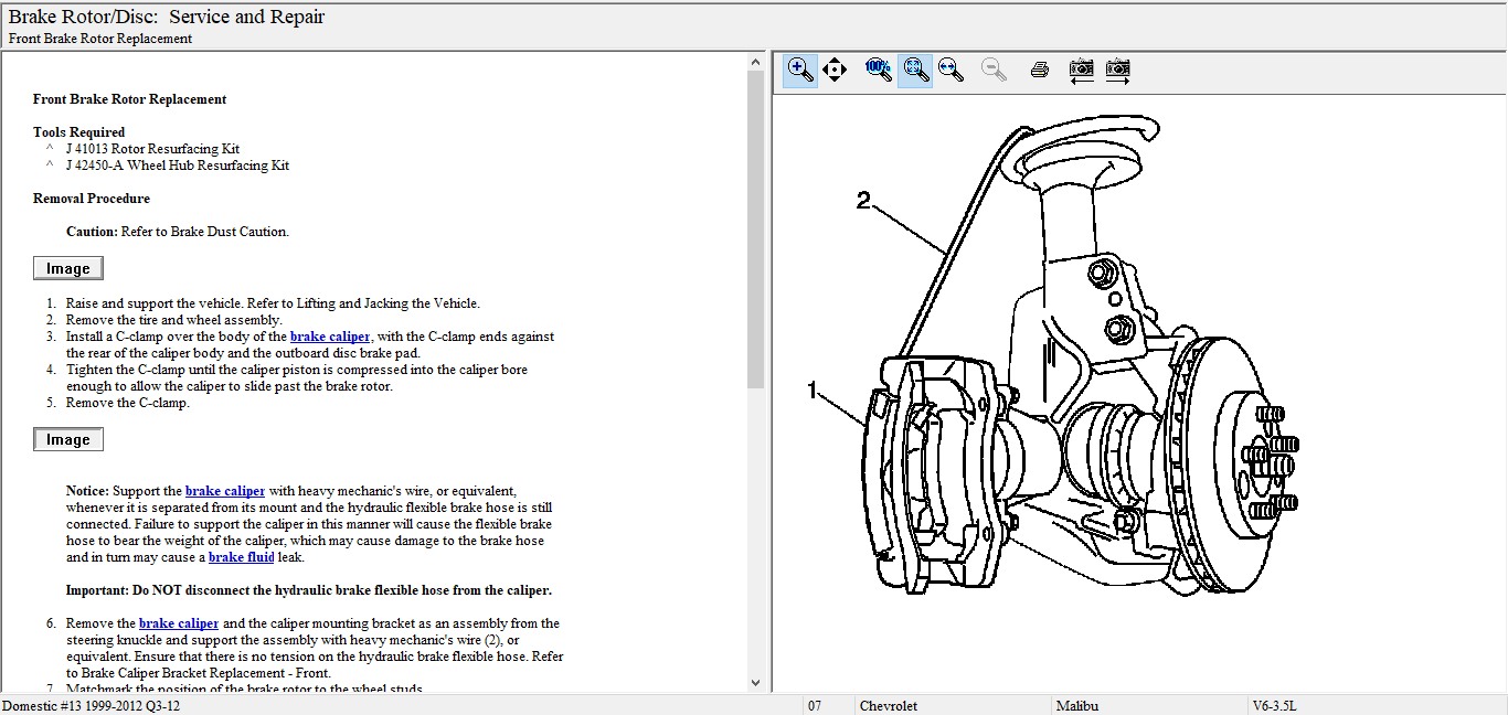

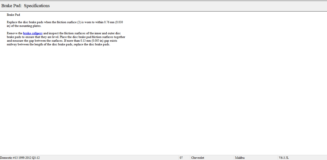

hello.

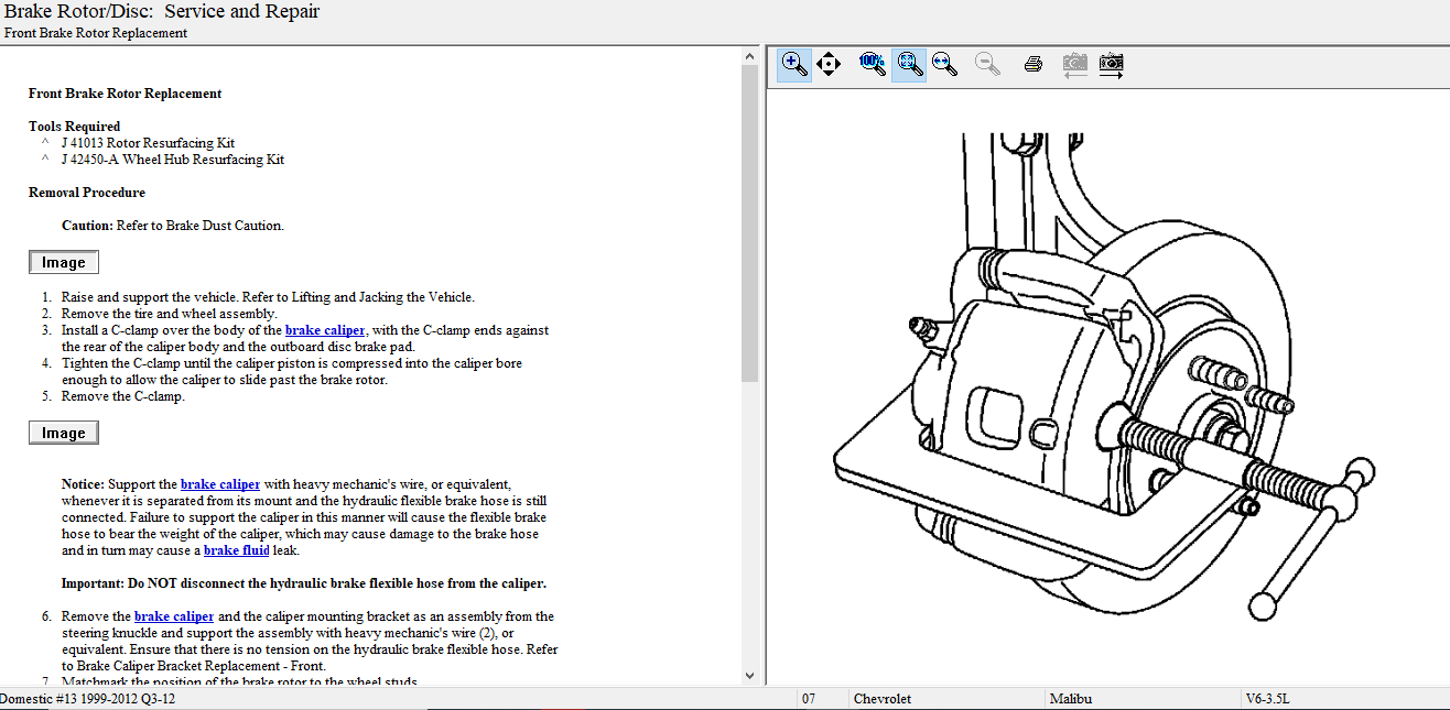

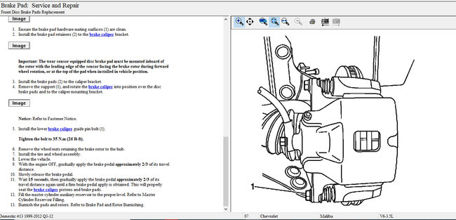

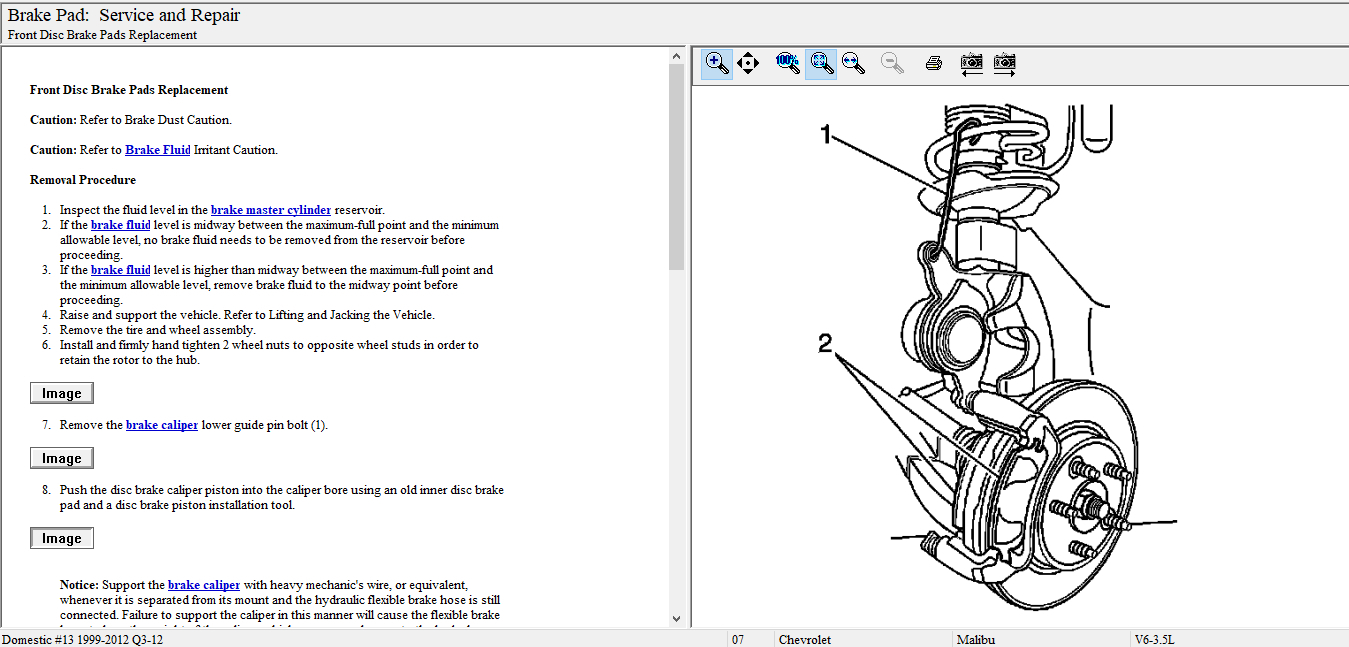

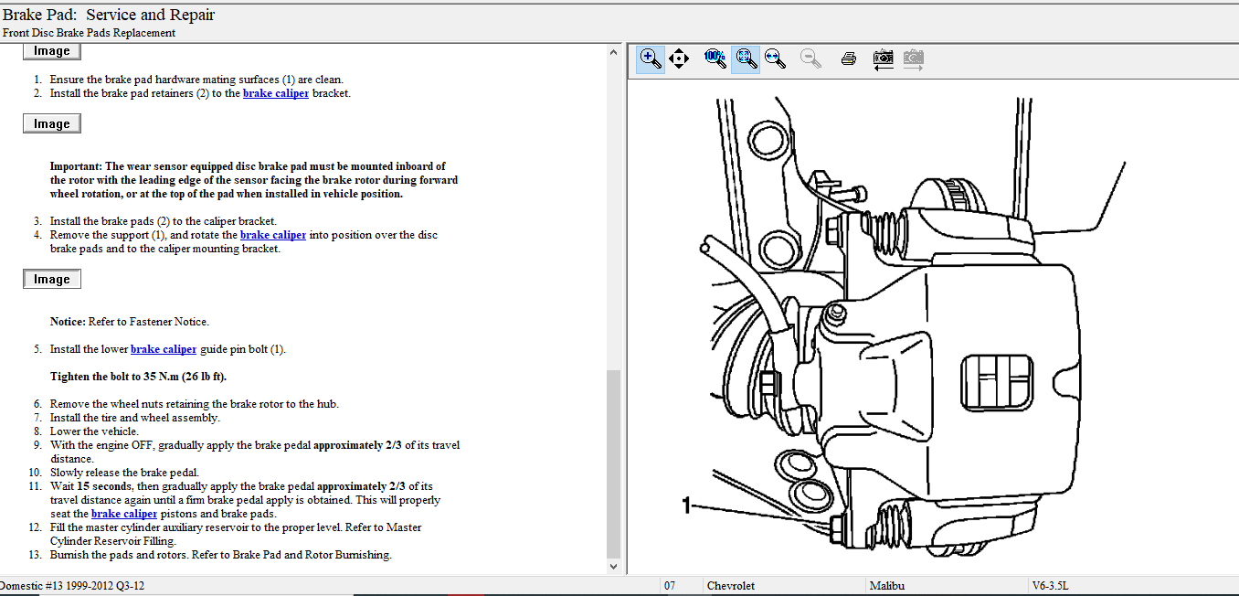

Yes, you can do the job by yourself just follow the instructions.
check our guide below how to replace the front pads and discs.

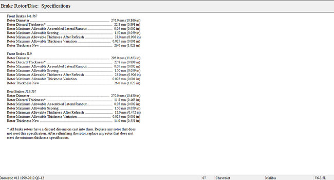

Check the diagrams below how to replace front pads and discs, and check the table for discs and pads specified measurement values.
hope these helps.
