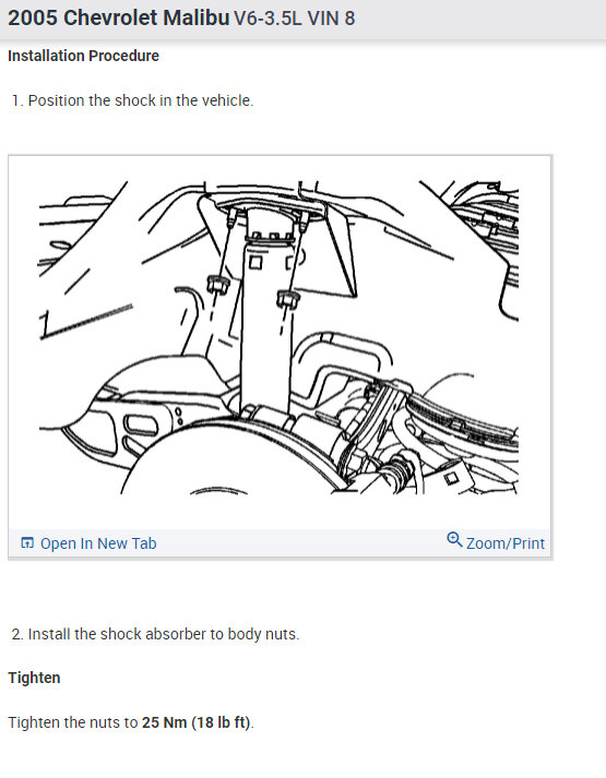

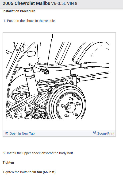

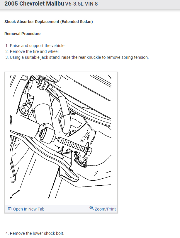

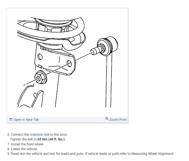

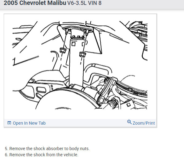

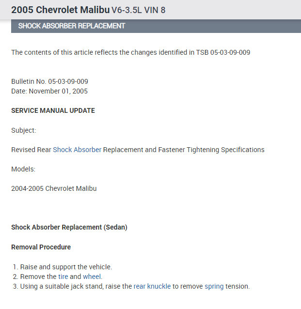

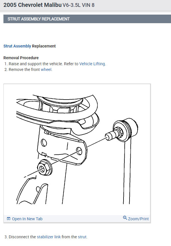

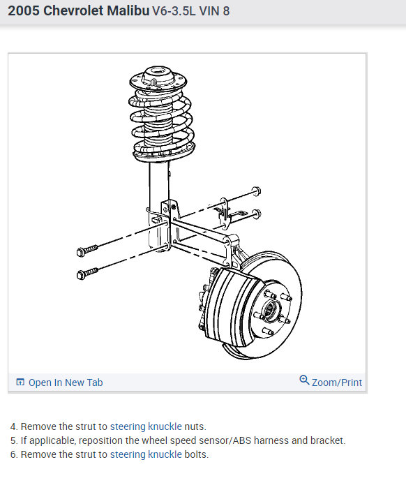

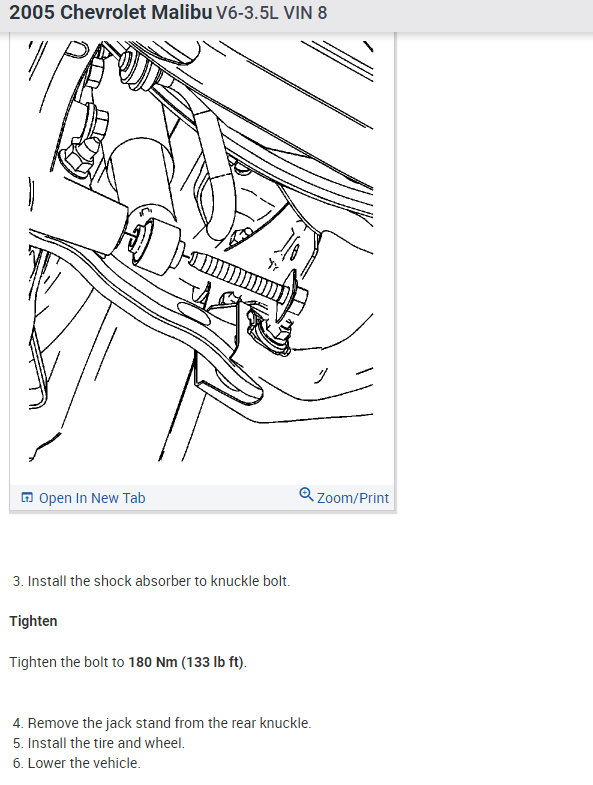

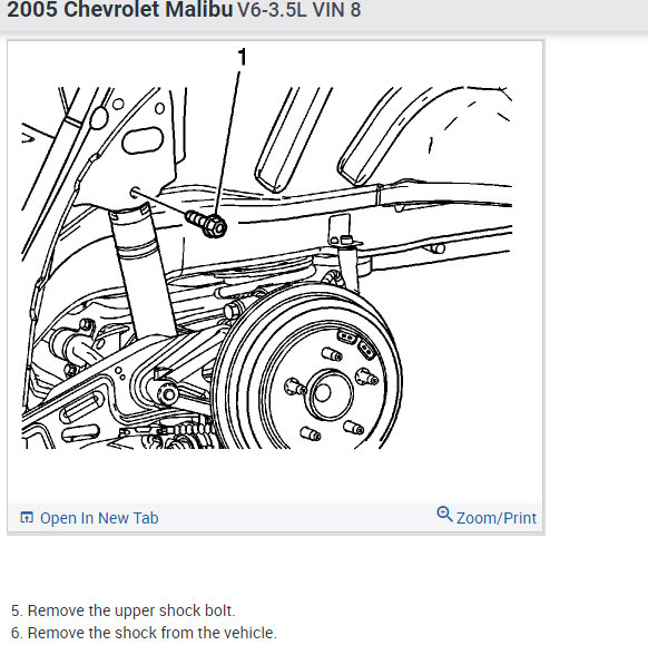

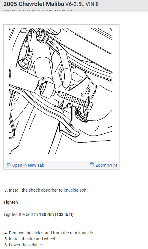

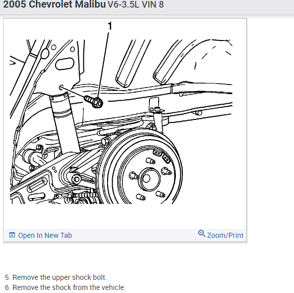

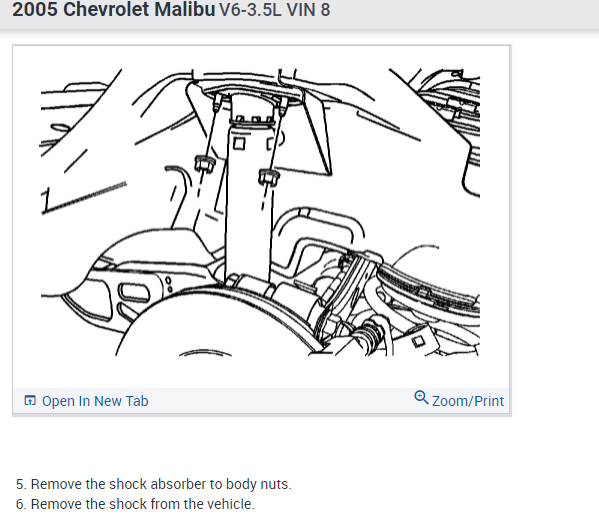

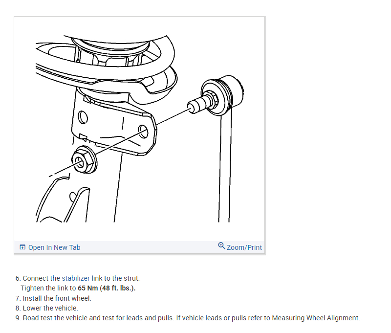

struts and shocks are leaking bad I need to change them.
Apr 15, 2009 at 6:25 PM
SQM
  • 6,383 POSTS
The struts on the front and the shocks on the rear can be changed out within few hours depending on your comfort level.
You will have to raise the vehicle and support it with jack stands to get started.
Here are couple of helpful articles:
https://www.2carpros.com/articles/how-to-replace-a-suspension-strut-and-spring
https://www.2carpros.com/articles/replace-shock-absorber

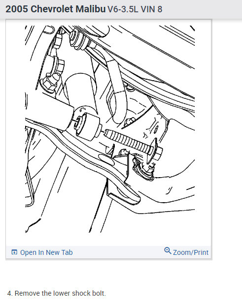

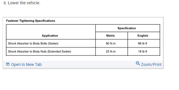

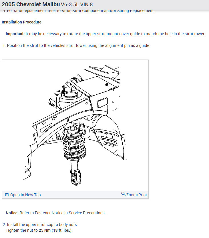

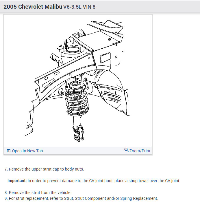

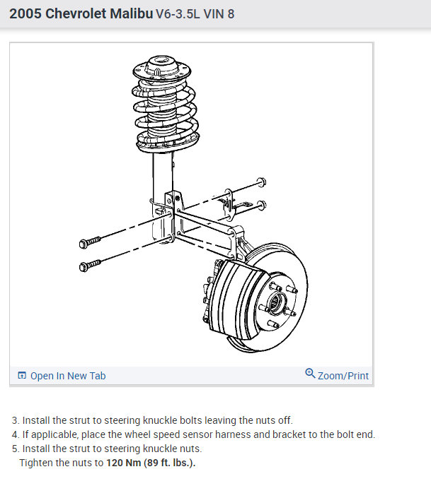

I have attached the replacement procedure for both the front struts and rear shocks.
