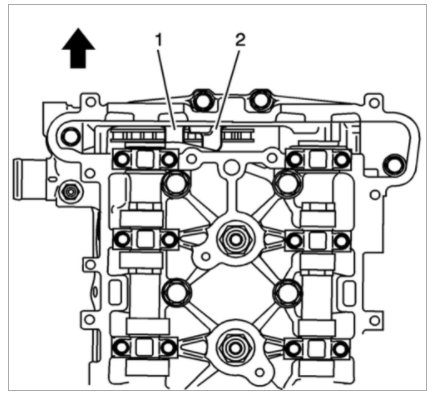

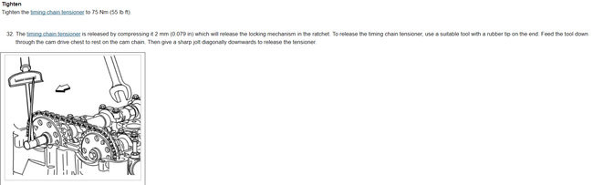

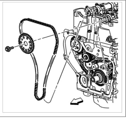

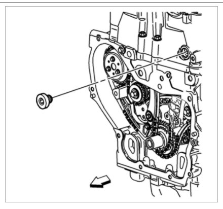

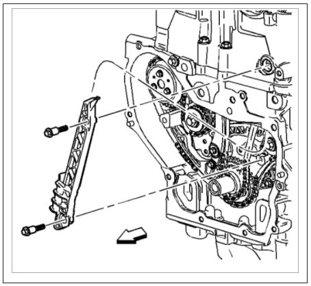

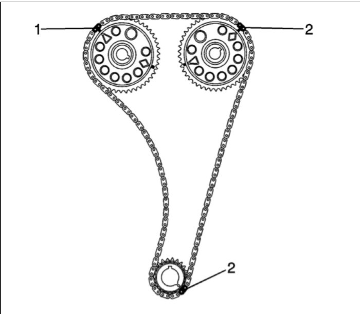

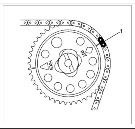

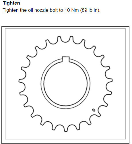

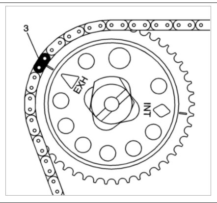

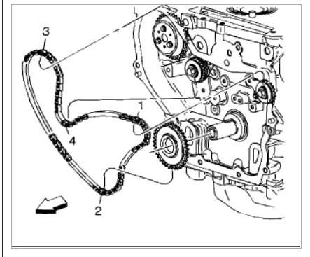

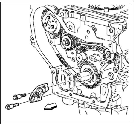

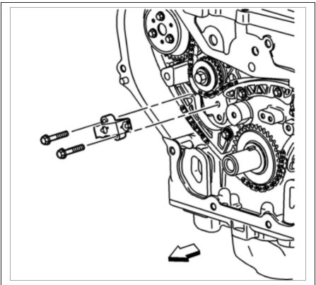

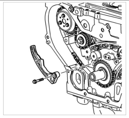

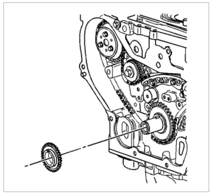

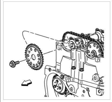

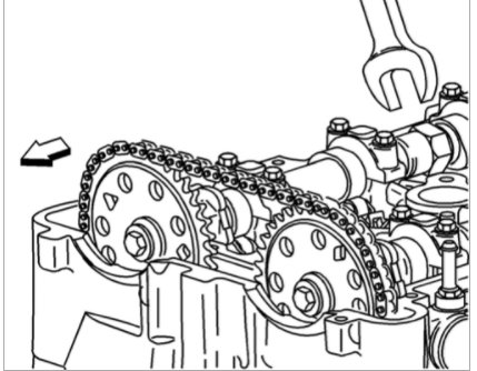

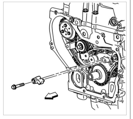

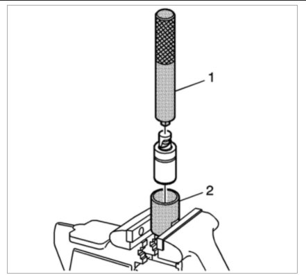

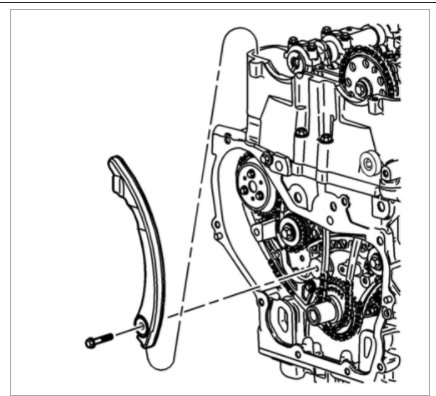

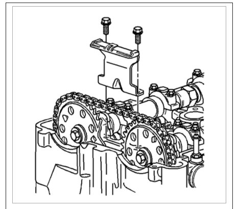

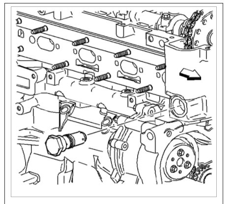

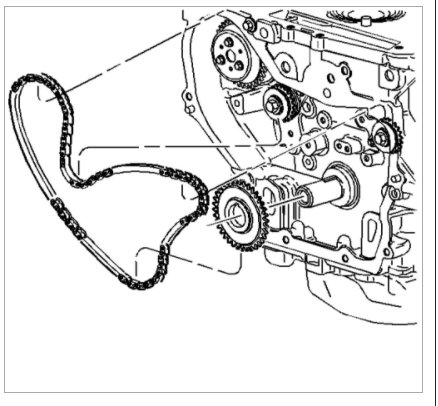

I need to set the timing chain marks. it is a 2.2L 4cyl, '05 Chevy Malibu. Can someone please help! It would also be very helpful if I can you find a diagram or schematic for the timing chain set-up (setting the marks) online or something. Anything will help. Thanks in advance!
Jan 9, 2008 at 3:53 AM
BMRFIXIT
  • 19,053 POSTS
You will need to start by disconnecting the battery and removing the timing cover here are all of the timing chain replacement diagrams the marks to get everything lined up (below)
