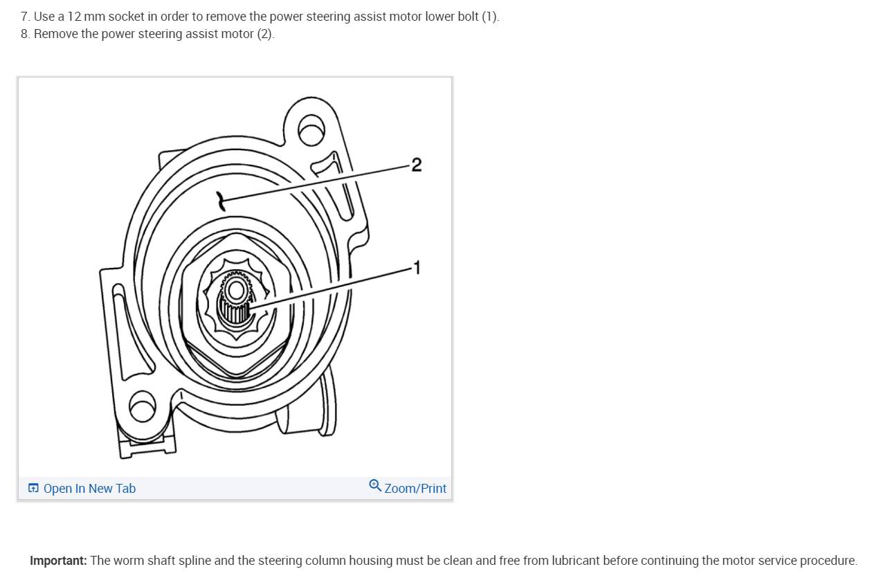

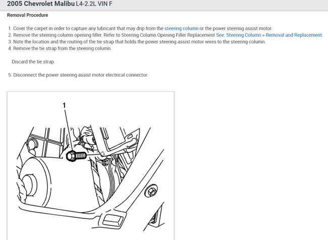

power steering light came on
2005 CHEVROLET MALIBU
JOHNFRAY

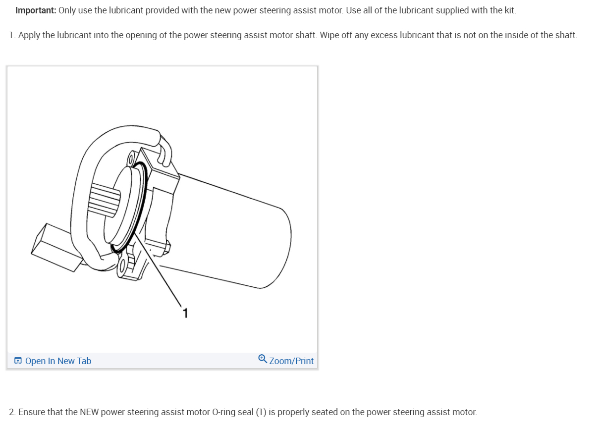

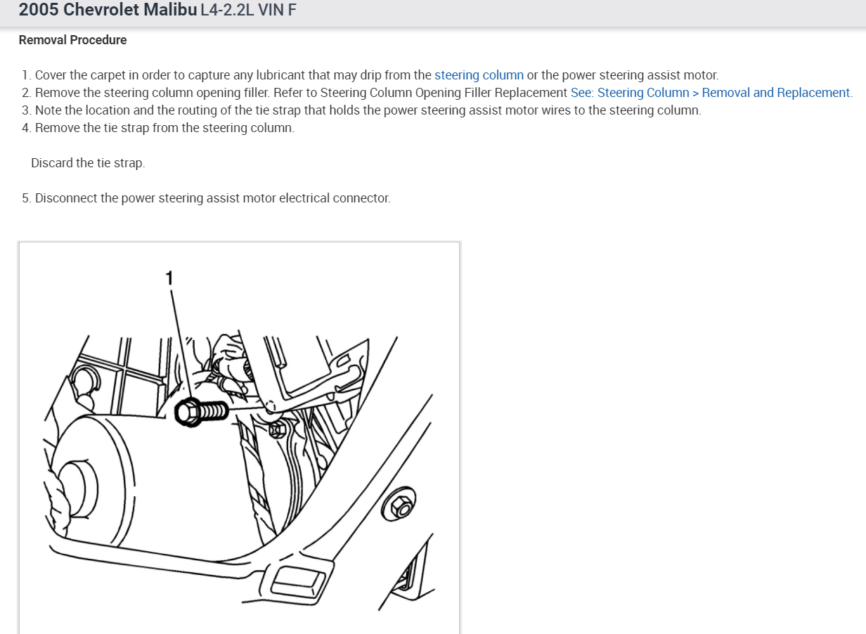

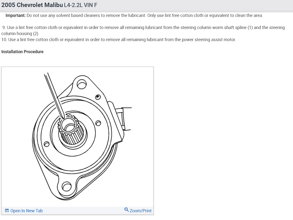

Why would the power steering light come on when its supposed to be an electrical type power steering system? What kind of problem could be lurking under the hood?
Dec 2, 2008 at 8:10 AM
DOCFIXIT
  • 18,828 POSTS

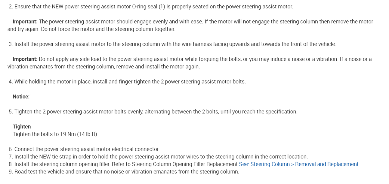

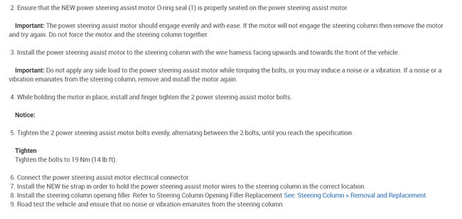

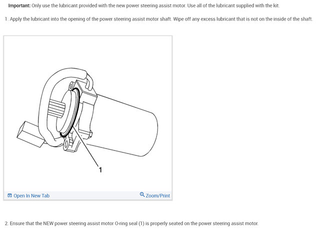

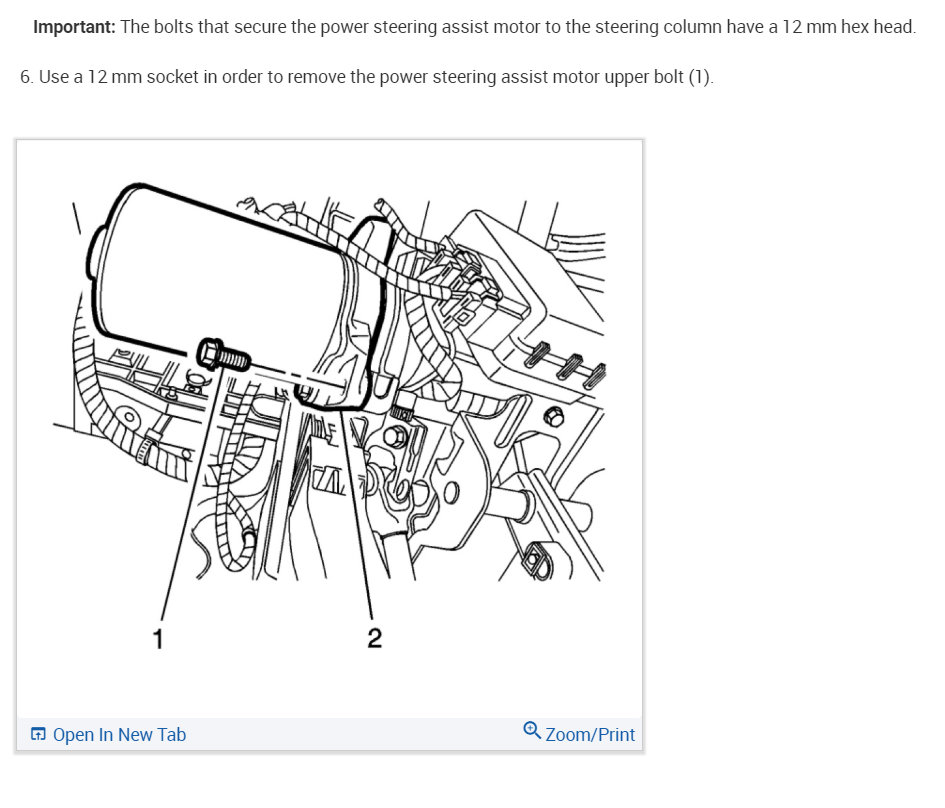

It sounds like the power steering motor is going out which is common here are diagrams and instructions below to help you change it out.
Dec 4, 2008 at 12:21 AM
HLACEFIELD
Thanks for this post I had this problem and got the motor for $150.00 used. All fixed! I love this site.
