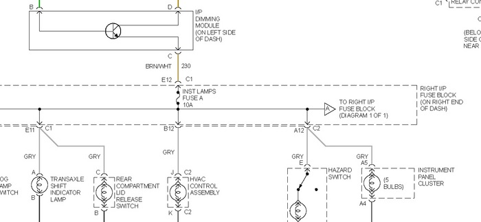

The dash, radio, and air conditioning lights are out, but the fuses are good. How do i fix this? I don't know what the problem is!
Apr 25, 2020 at 6:26 AM (Merged)
RENAUDTN
  • 636 POSTS
Go to a dealer and have your BCM scanned.

All the warning lights come on, check fuses on both sides and underhood, they all have power, tail lights work.
Replaced dimmer switch, replaced light/wiper switches
I still have no dash lights....hard to drive at night....
Do you have wire diagram?
BMRFIXIT
  • 19,053 POSTS
does the radio and clock and the other dash light if any work and dim
if so u need to replace the light bulbs in the back of the instrument panel
if not turn light on and check fuses

BMRFIXIT
  • 19,053 POSTS
turn light on and check the fuses again
check headlight switch
check wiring
radio panel lights and shifter light all come from one source
