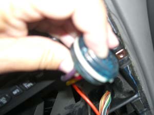

SHERRIEMYERS
Hi Docfixit- I checked the purple hose and no vacuum. I removed the controller and then unplugged the mode selector and placed my finger tip over the hole where the purple tube is - and nothing. The car was running and the air was on.
https://images.2carpros.com/forum/automotive_pictures/373526_purple_hose_controler_1.jpg
Apr 25, 2020 at 1:26 PM (Merged)
DOCFIXIT
  • 18,828 POSTS
O.K. purple hose must go through firewall and attach to intake manifold for vacuum. I can't tell from info i have where but search around it will be only hose through fire wall. will most likely be black in engine compartment. And should have a check valve in line.
SHERRIEMYERS
I have tried following the purple hose through the fire wall with no luck - I have taken the glove box out and it looks like the group of hoses enters into some kind of conduit and I can not see any thing from the inside of the fire wall - any Idea where on the intake manifold it might connect?
DOCFIXIT
  • 18,828 POSTS
It goes into the wiring loom then out to enginel Look at top engine toward rear see the wirng loom out of it comes a vac line it should be purple but by now it may have faded to white, it connects to intake next to fuel pressure regulator.

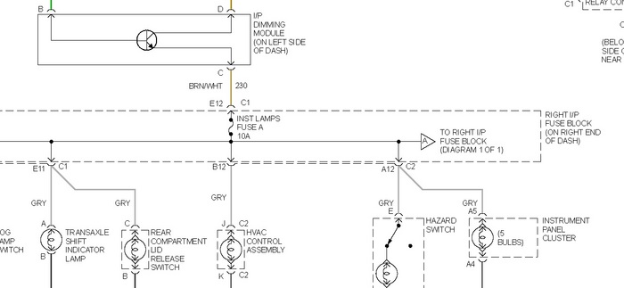

LEE.WILKERSON
On my '98, there is a one-transistor regulator mounted to a bracket above the brake pedal near the steering column. T0-3 case - 2N3055 or ECG 130 perhaps. More 2 come...

KIMMH012
All the warning lights come on, check fuses on both sides and underhood, they all have power, tail lights work.
Replaced dimmer switch, replaced light/wiper switches
I still have no dash lights....hard to drive at night....
Do you have wire diagram?
BMRFIXIT
  • 19,053 POSTS
does the radio and clock and the other dash light if any work and dim
if so u need to replace the light bulbs in the back of the instrument panel
if not turn light on and check fuses
KIMMH012
[quote:868fea8279="BMRFIXIT"]does the radio and clock and the other dash light if any work and dim
if not turn light on and check fuses[/quote:868fea8279]
it is a walmart special radio - and the lights do come on....
what light bulbs in the back of panel? all the warning lights are working....headlights, highbeam on dash..these all work...just no night lights to see panel.
also noticed that the shifter lights don't work - the one between the seats...can see at night...
They all use to work, then just one day started the car and NO dash lights
BMRFIXIT
  • 19,053 POSTS
turn light on and check the fuses again
check headlight switch
check wiring
radio panel lights and shifter light all come from one source
