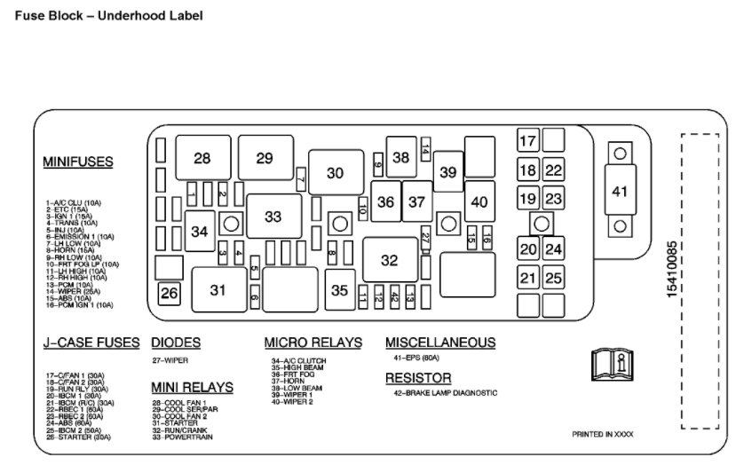

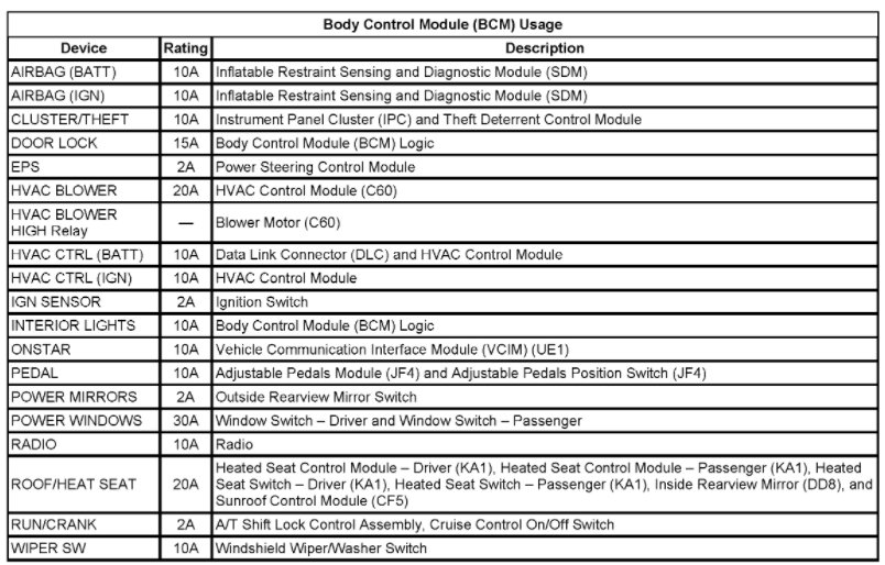

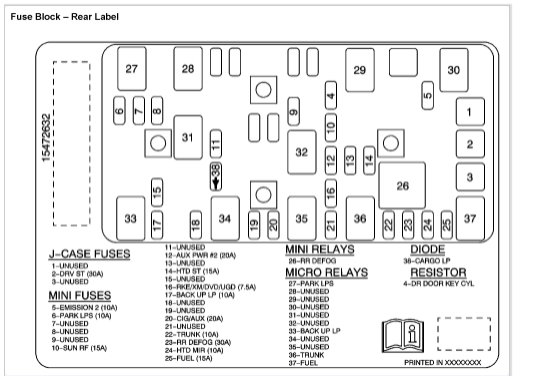

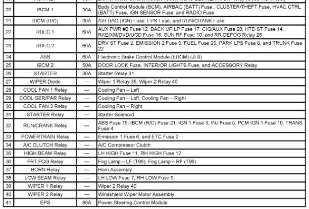

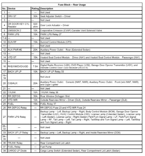

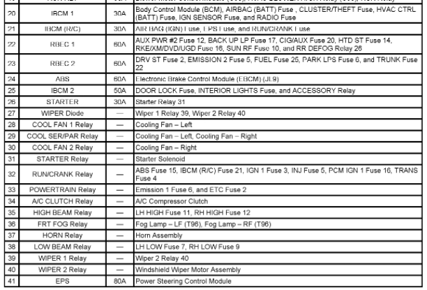

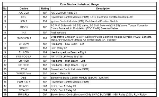

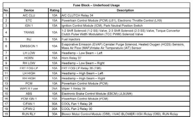

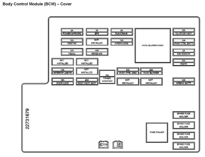

My shift lever does not lock I think it is a fuse can you help me test the fuses and give me the location please?
Sunday, August 10th, 2008 AT 8:24 PM
DANNY L
MECHANIC
5,648 POSTS
Hello, I'm Danny.
Here is the information you requested. Here are a few tutorials for you to view on how to check and replace fuses:
I've attached pictures below showing the fuse and relay locations on your car. Hope this helps and thanks for using 2CarPros.
