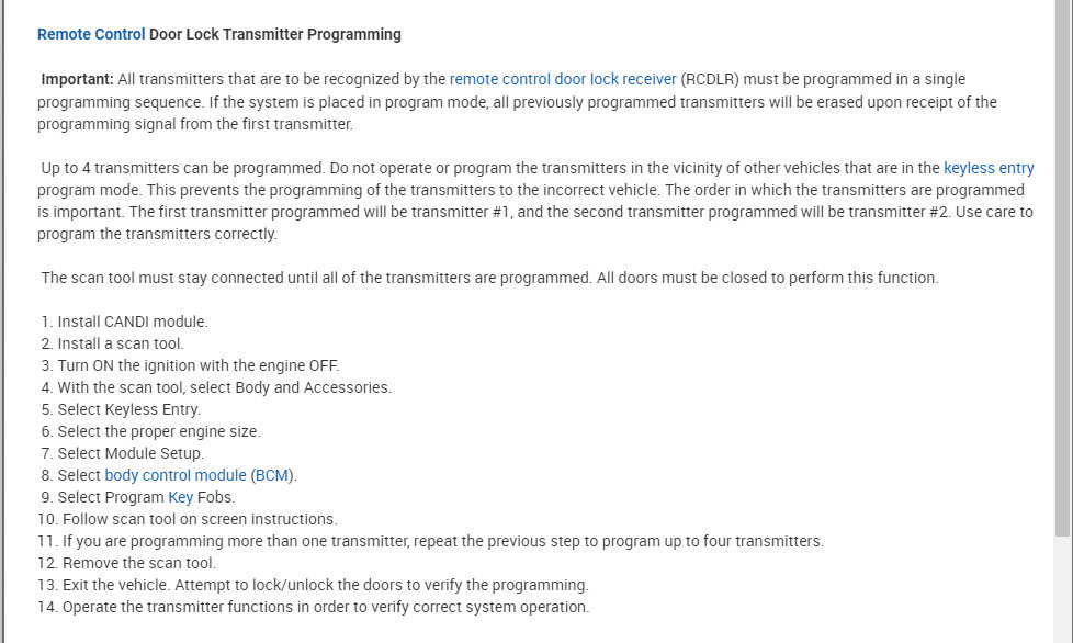

First of all I appreciate any help you can give!!! I am a broke single mom so trying to do this as cheap as possible! I need to know the steps to programming a remote start for my factory installed remote start on my Malibu. It's the key fob that I need the steps for programming. Do you have those exact steps by any chance? Again, thank you so much for any help and Merry Christmas!
Dec 23, 2009 at 12:24 PM

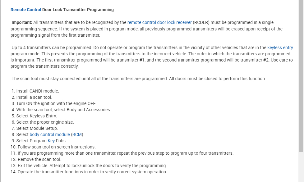

I will attach the info on how to program a remote transmitter but the most common reasons for this to not work on this generation GM products was the fob itself but then next is the remote-control door lock receiver
Here is a guide that will help with this:
https://www.2carpros.com/articles/how-to-re-program-a-key-remote-fob
Below are the steps that you need. However, if this does not work then we are going to have to check for codes to find out if there is a possible issue with the RCDLR.
Please find the info attached and let us know what you find. Thanks
