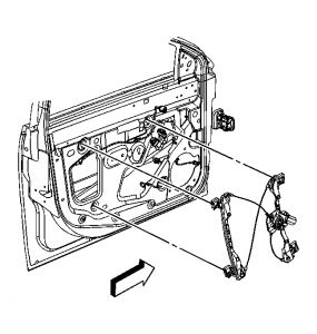

2004 Chevy Malibu how to change power window motor drivers
89,000 MILES • 4 CYL • 2WD • AUTOMATIC
WBEADS
can you explain how to do it, from removal of door panel
Sep 19, 2010 at 6:07 AM
BLUELIGHTNIN6
  • 16,542 POSTS

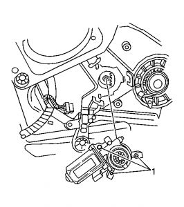

you need steps on removing the door panel or you don't need them? after door panel is off all you do is disconnect electrical connector from the window motor, remove the window regulator from the glass, raise the window and secure it in position. remove the regulator and then remove 3 screws from regulator motor.
