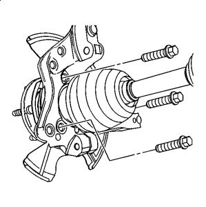

Do I need to replace the whole axle shaft or is there an outer wheel bearing

Nope remove axle nut
Then remove caliper and rotor and then three bolts then bearing hub
