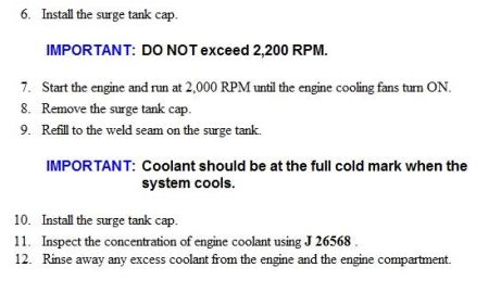

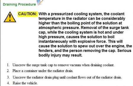

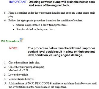

Can someone tell me how to change the engine coolant for my 2004 Chevy Malibu, 2.2L, 4 cyl.
Friday, June 11th, 2010 AT 3:23 PM
BLUELIGHTNIN6
MECHANIC
16,542 POSTS
+1
Friday, June 11th, 2010 AT 3:42 PM
