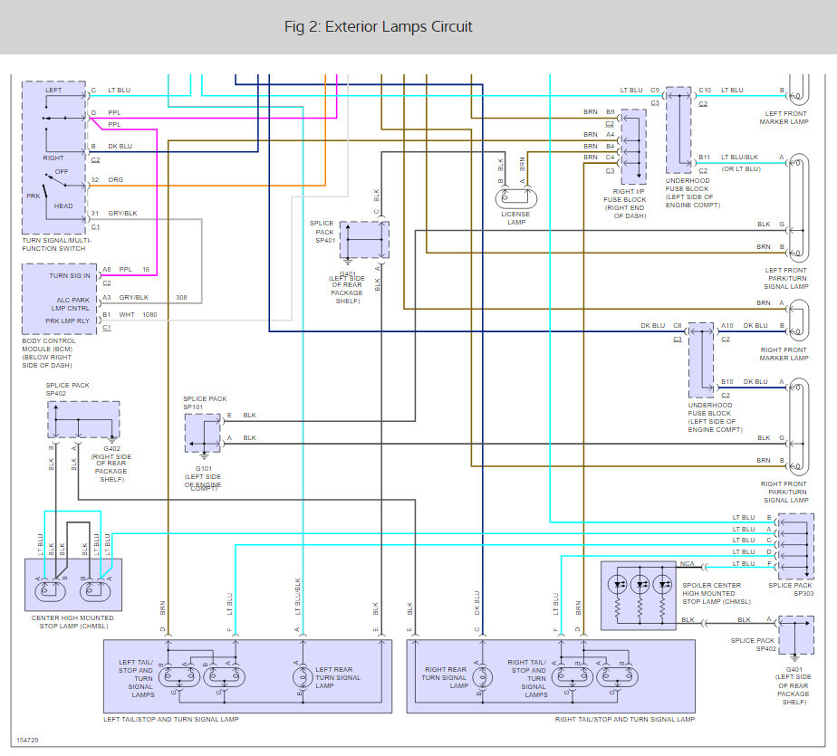

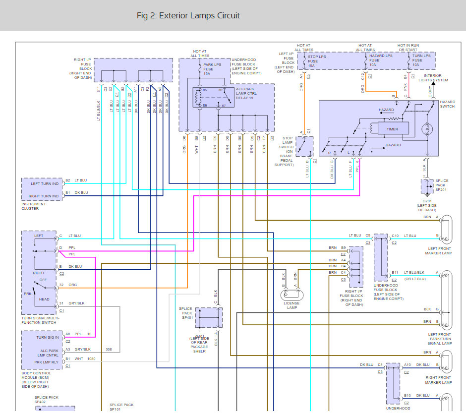

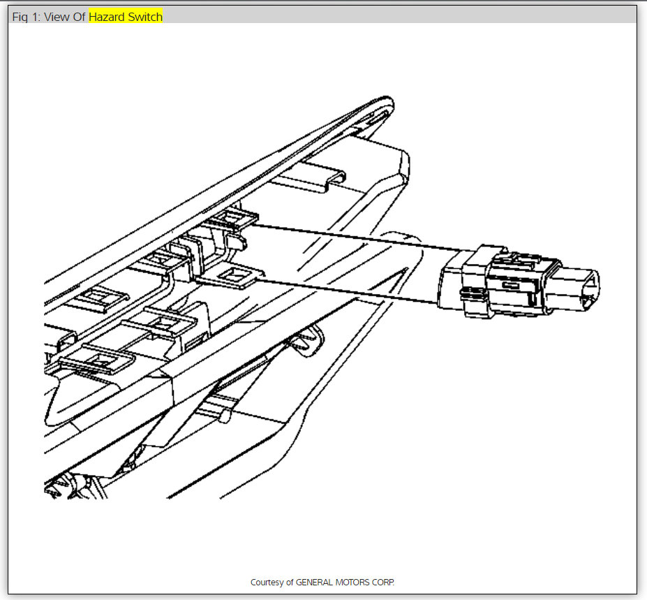

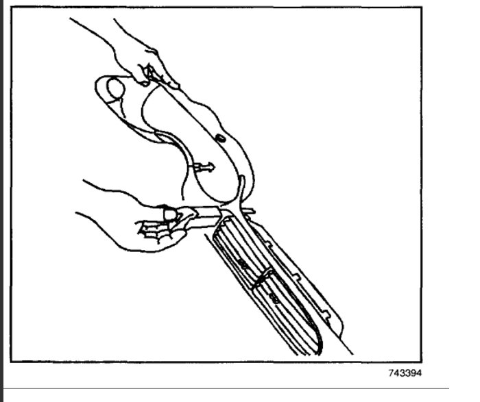

They had big problems with the hazard switch (flasher for both systems blinker and hazard) in these cars which is where the flasher is located. Here is a wiring diagram and a guide to help you test and confirm the problem and the location of the flasher below.
Diagrams (below)

The switch and relay are built into one unit and are located on the dash, to the right of the instrument cluster.

The turn signal flasher is common to the hazard warning flasher. It is located on the Hazard push button on the dashboard.
