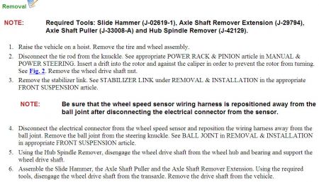

how do you remove the half shaft
Nov 3, 2010 at 4:13 AM
SERVICE WRITER
  • 9,123 POSTS

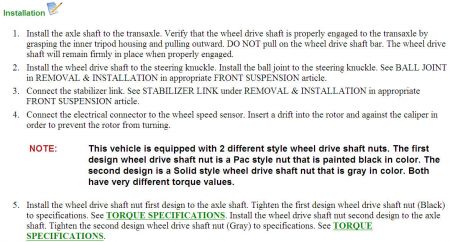

I'll give you a procedure and will post it. However there are situations that involve some tools and finess that is not best understood until the particular situation occurs. I will post the procedure but when you do it..make sure someone is here when you need them...which may not be possible. OR be prepared to let it set until then.
I will update with a procedure.
Nov 3, 2010 at 12:31 PM
SERVICE WRITER
  • 9,123 POSTS
Get a new axle nut P/N 10289657 The revised torque is 173 ft ibs. The reman shaft you buy may have it..check first.
https://images.2carpros.com/forum/automotive_pictures/30961_mal1_1.jpg
https://images.2carpros.com/forum/automotive_pictures/30961_mal2_1.jpg
