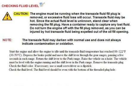

Transmission problem
2003 Chevy Malibu 6 cyl Automatic 60000 miles
Where is the transmission fluid located at?
Saturday, January 30th, 2010 AT 7:40 PM
BLUELIGHTNIN6
  • 16,542 POSTS
I'm assuming you mean how do you check the tranny fluid, it is tricky because it does not have a dipstick. Follow the steps below to check the tranny fluid level in your Malibu..
