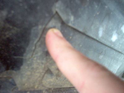

I have this problem where the engine gets much louder, yet at a lower pitch whenever I come into a heavy/hard rain while driving. This is the only time this occurs, and after I get out of that area of heavy rain, it stops. There is no difference in the RPM reading, nothing visibly occurring with the electrical system, and the "Check Engine" light does not pop on.
This has been a regular occurrence over the course of the last year. I have taken it to the mechanics at different dealerships who have either thrown their hands up, or want to see the car in the exact conditions. I do regular maintenance, I have had the serpentine belt replaced, and the pulleys inspected (due to my complaint on this problem) during the course of this continuing problem.

Did noise start after new tires?
Apr 20, 2009 at 4:37 AM
MILBFAN
  • 7 POSTS
Nope; the tires were installed more than 2 years beforehand.
Apr 20, 2009 at 6:30 AM
DOCFIXIT
  • 18,828 POSTS
All roads make noise in rain? Is any of the air dams under car missing?
Apr 20, 2009 at 7:28 AM
MILBFAN
  • 7 POSTS
Yes, this noise occurs on any road - surface street, interstates, highways, etc.
How would I know about the air dams that you are speaking of?
Thanks for taking the time to help.
Apr 20, 2009 at 7:36 AM
DOCFIXIT
  • 18,828 POSTS
All the plastic pieces around wheel well, between radiator and engine and and behind radiator support. I'm thinking the water is into engine compartment and hitting bulk head. Making noise

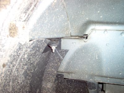

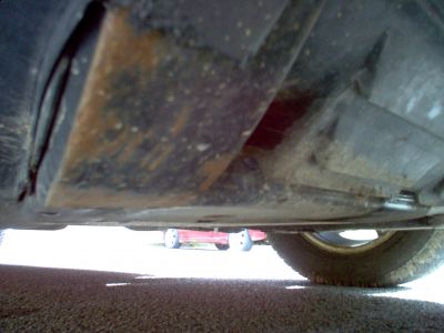

Sorry it took so long; I decided to try and take pictures to give you an idea of what I saw that might be the culprit.
https://images.2carpros.com/forum/automotive_pictures/346277_IM000154_1.jpg
Here is one thing I found interesting. This is actually behind the air dam, on the right front side of the car. There is a hairline crack there, and the piece feels loose towards the bottom.

https://images.2carpros.com/forum/automotive_pictures/346277_IM000138_1.jpg
This is in front of the air dam, on the right side. I noticed the material didn't seem to be as secure as on the left side.

This is the only other weird thing I came across; this is on the driver side front wheel well. The material comes up and is just cut off to make room for the nut and screw. Thanks.

In the wheel well There should be a black plastic molded piece that goes from front fender across top of tie and down to bottom of well . I did not see that in your photo the last one. you should not be seeing the painted inside of fender. Water comming off tire and hitting metal would make big noise ie. metal roof

So to make sure we're on the same page, your concern is with the driver side wheel well, where that screw and nut are, and the black part is cut off/looking weird? That's the only place where the two wheel wells aren't identical (both sides have the black plastic arching around the well, but the passenger side piece is whole, and not awkward-looking like this one in that spot). I can try and take more pictures sans a flash if that is needed (or if there's something else you need to see).
