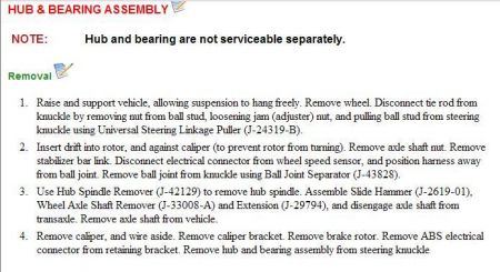

noise is coming from the front of the car and sounds like a wheel bearing going bad. when you turn the steering wheel to the right while driving the noise increases. how do you replace the hub assembly?

https://images.2carpros.com/forum/automotive_pictures/261618_Noname_1261.jpg
https://images.2carpros.com/forum/automotive_pictures/261618_Noname2_372.jpg
