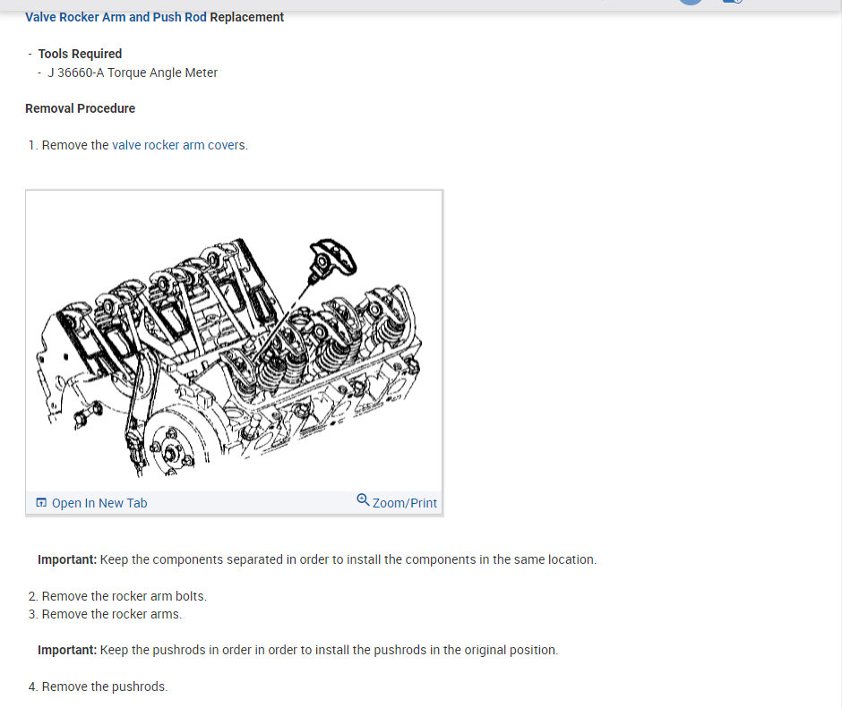

where are the push rods and in what order do they go?
Oct 4, 2008 at 4:01 PM

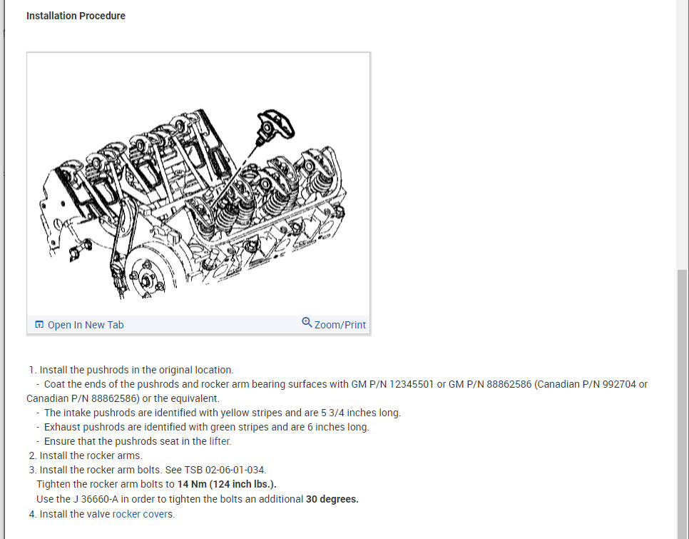

These push rods are different length for the intake and exhaust. The OEM push rods are marked with a color code to identify them. However, I attached the process below.
The intake are yellow striped.
The exhaust are green striped.

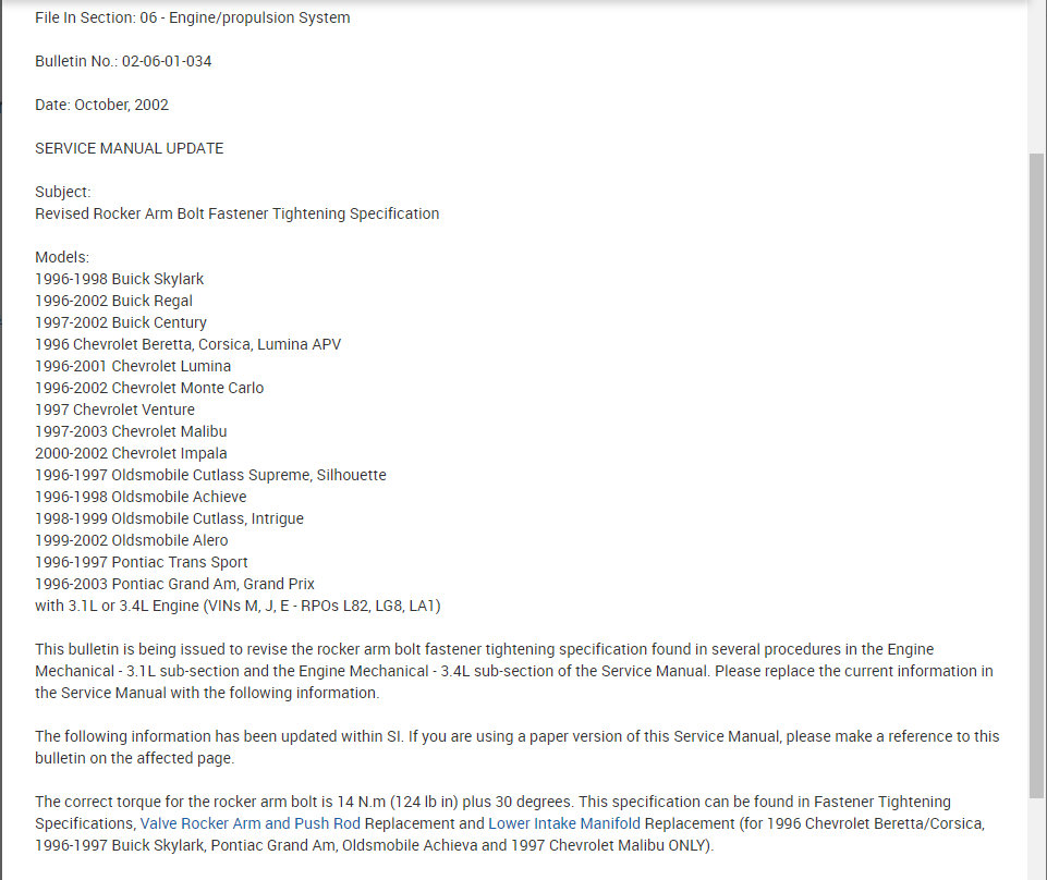

Please see the attached info below for more detail including torque specs. I included the TSB that is mentioned in the process.
